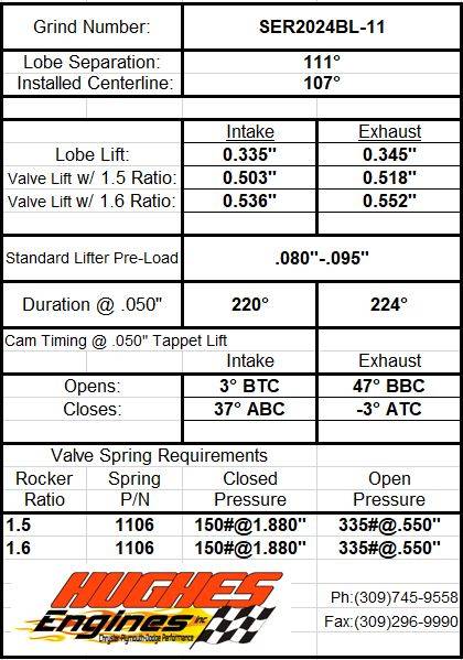

I filled out Hughes 21 questions for cam advice. I ran across this cam. Any thoughts. Looks like Hughes is selling Hy-lift
It's a nice smaller cam.
.520 is about max with the Stamped. The Stamped steel rockers usually run less then 1.5 so you can go a little bigger. But longevity isn't good.
What rockers?
