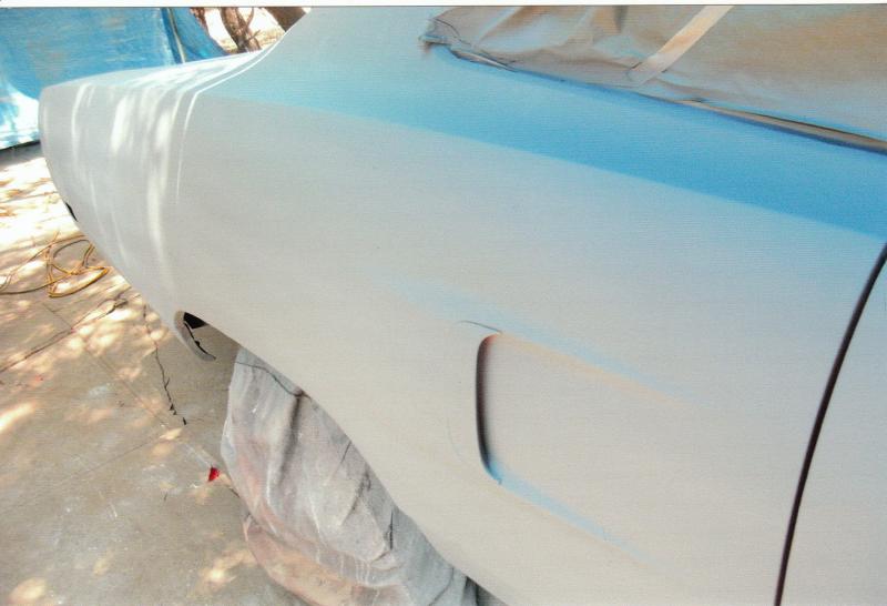

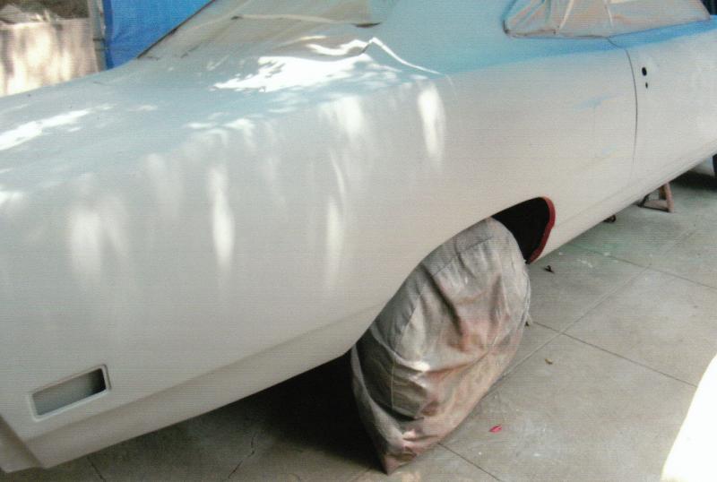

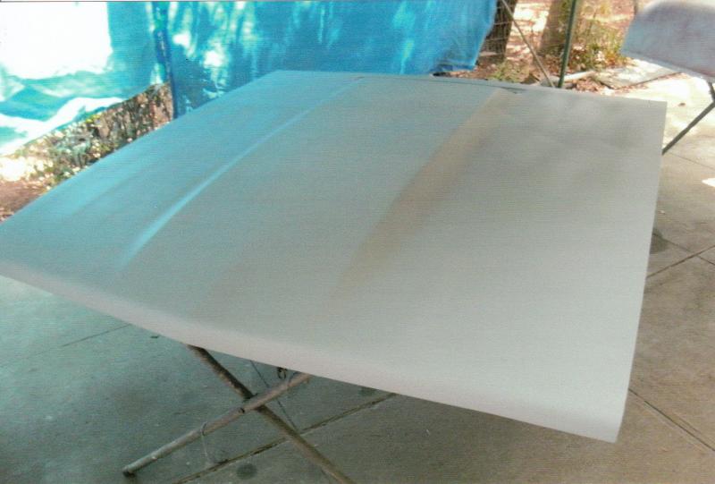

Update

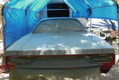

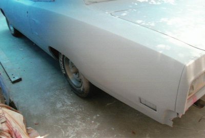

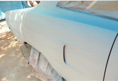

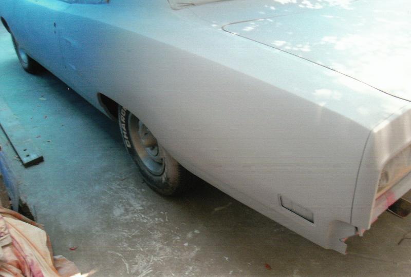

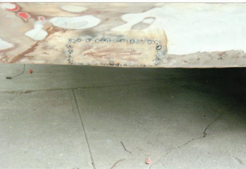

Here's the latest. Plenty of photos. Take a look at the damage on the right quarter panel. That was the only serious rust spot on the car other than the holes below the rear window. I know not everyone's gonna love the work we're doing, but it's a friend helping me and to watch it is nothing short of miraculous. Bodywork is a real art form...

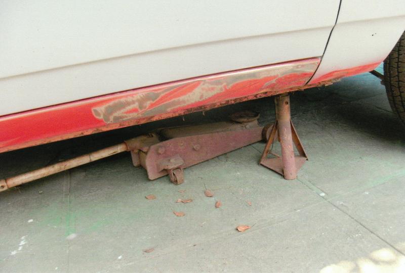

The right rocker panel was smashed in - like the last guy drove over a curb and just rode down the rocker to the street. The picture really doesn't show how bad it was. He worked on it for 8 hours with a puller and a hammer. I swear there's more filler in the puller-holes than there is in the dent! Like I said - pure artwork...

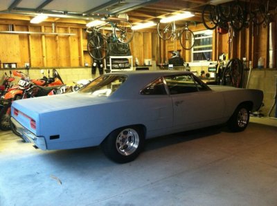

Back from the painter with the bodywork and primer complete. This is my chance to get the rest of the major mechanical stuff done before I have to worry about scratching all the fancy new paint.
And with a new-used set of Budnick "Famosa Dished" wheels - a lucky internet find. For guys with tire fit questions, those are 15x7 225/60/15 with 3.5" of backspacing on the front, and 15x10 275/60/15 with 5" of backspacing on the rear. It's 10.25 inches from ground to bottom of the weld seam just in front of the rear wheel, and 8.675" for same measurement right behind the front wheel. We call that the California Rake. LOL
The fronts fit perfectly. The rears are just a little tight, but fortunately my car "came with" (or came to me with at least) the inner skirts on the rear quarters neatly folded up in to the fender well. Also my 40+ year old rear leaf springs are pretty much shot, so I'll probably get another inch or so of height in the rear when I get some fresh ones on there.
Startin' to look like a muscle car! :grin:
