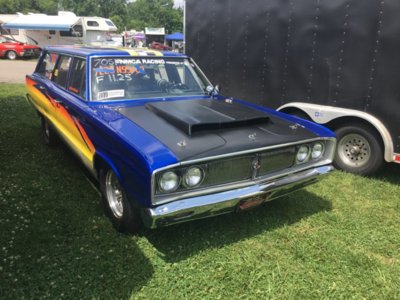

I weighed my 64 Sunday it was 3350. All steel except fiberglass hood that's hinged with springs so its heavy. All factory glass, I have taken a lot of weight off the front with cm struts, steering shaft, drag link, and modified k member. I'd say try and get any weight off the front.
I weigh 182 after a 20 lb reduction this spring. Race weight was up to 3480 and throttle pulled back .350" to hit 9.25 Saturday
Doug
Doug posted your car in a vid NSS. It leaves real nice! You've got a very nice Plymouth!
