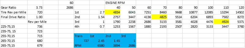

The information above, broken down to RPM, shows the engine speed with a 3.73 with a shift of 40 for 1-2, 70 for 2-3, and 110 max for 3rd. Maintaining a 5000 max shift point. Cruising speed around 65, just over 2000 RPM,

The chart is one that I made up. Pretty good at excel so built the formulas and started playing with possibilities. Rpm changes with change of gear, tire sizes. Helped me find my happy points.
