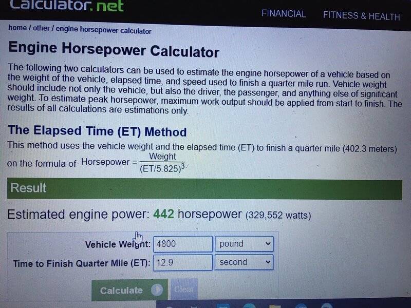

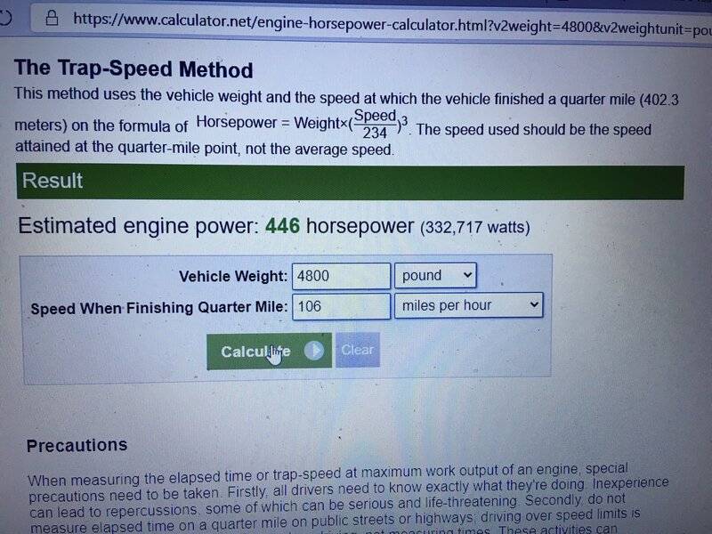

On post #67, I gave screen shots of the HP calculator that was used and numbers I input.
I have a 2016 R/T 5.7,only mods from stock are: factory 6.4 exhaust manifolds, and exhaust, and factory 6.4 intake, running stock 5.7 injectors, with a CAI, and tune. I also have 3.90 rear from a stick Challenger. So it started at 370HP, but I have a bit more, but I dont think I have added 76HP.
With me in it and I think it was just over 1/4 tank of fuel, and spare tire it weight was 4800lbs, My best ET 12.9@106

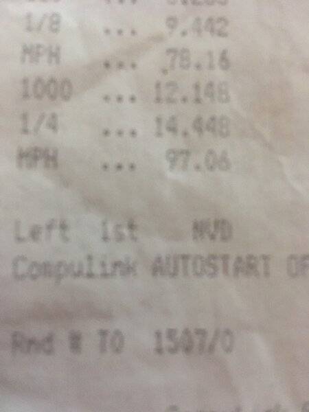

Here are a few pics, and time slips, the lower one is from first run, I spun bad coming off the line,
last run of day, I dropped air pressure in my 14 inch cooper cobra's and got a 14.2@98mph
I was very proud as it was Close to 1967 Hemi Charger times.
Sorry the photos are old, and they are photos of photos, LOL

The 14.7,one, I left way late(not that that changes anything but R/T) Then I blew the tires off, let off, spun again, and then got it together.
I also remember that day, one of the last passes, the car getting squirrely 3/4 down the track,(at maybe2-3 shift??) was the first time I had that happen, was a little bit alarming for it being my first time at the drag strip with this car, never really got her crossed up at speed going straight untill then, LOL!!!!!
It was at Hemmings Musclepalooza #1!!!!
