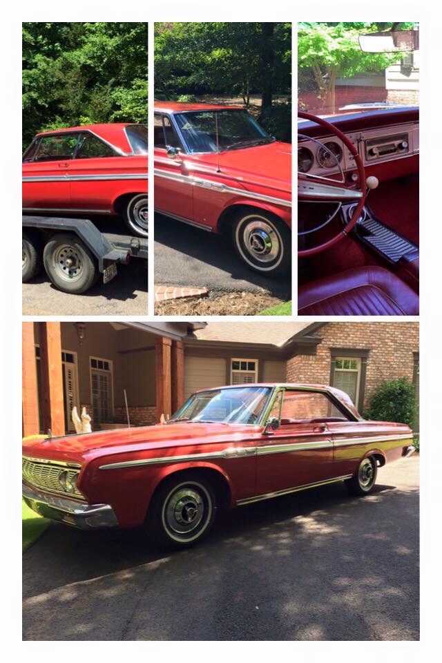

On Badverts advice I went with the same thing he did. Same part #, cost and all from Summit. Thx to him I have the 2" I needed in the back for tire clearance. Easy to put in and worked like a charm.
