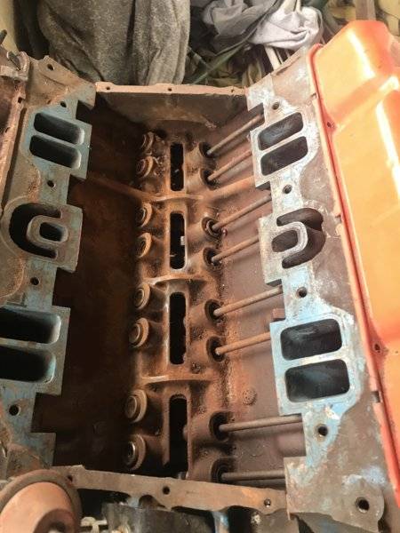

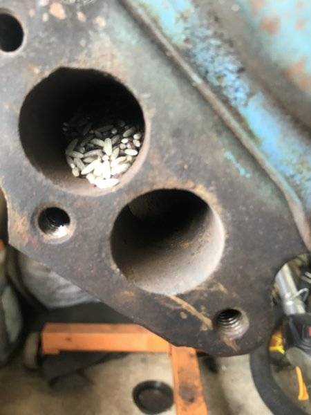

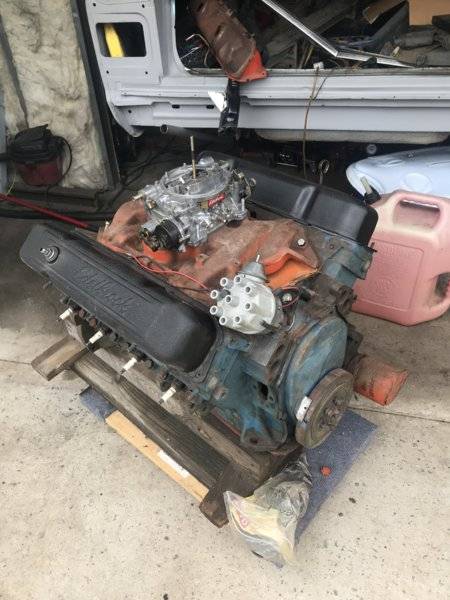

Maybe this will help.. A guy down the road told me he had a rebuilt 383 in his garage and I swapped him work for the engine. I finally got the engine but it was a disaster. Stored? Yes Stored correctly? Negative this thing was a habitrail for all the little creatures that lived in his garage. The entire cooling system was full of uncooked rice it literally took me 2 hours to get it all out of the block. I tore it down to the bare block used air and washed the complete block and cleaned every hole in the block. Its now ready to be put back together but what a waste of time if they would have just stored it the correct way. Pulled the valley pan to discover a huge mouse nest with one dead mouse still in it. Here is the result of a year or 3 of rat piss.
Lifters will need to be disassembled and cleaned, or replaced. The oil will have gelled, and the lifters will be stuck. Valve springs will NEED to be replaced, and bearings should be replaced too. Contaminants in the oil will attack the bearings and turn them black. Check all surfaces for damage or rust. However you deal with the piston issue, do NOT forget to rebalance the motor.

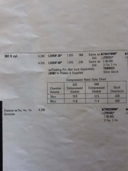

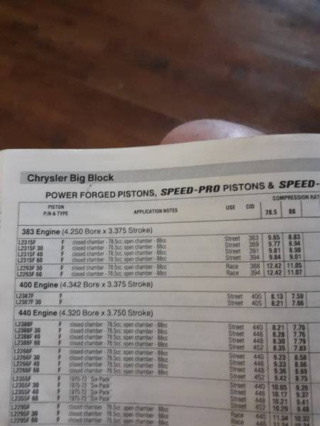

This isn't really any new info for you but the image is right out of my 1989 TRW book and a 1996 Federal module book ... most 906 head we have measured have been 90cc making it about 11:1 but I would guess 10.75 :1 or less since factory machining vary A LOT. You would have to measure the piston deck height. The 12.4 rating is for a closed chamber head. On any used engine spin it over for tight spots...take a valve cover off look for rust. The seller should be concerned what he is selling..or you need to buy from some one who cares. And as far as rodents..2 years ago I had a critter chew a hole through a intake hose on a 8.3 Cummins diesel and filled the engine up with soybeans 2 the point the engine locked up. I didn't have 2 overall it but had to do the valves and take it completely apart. Mouse pee is super corrosive. Lol. The mice moved 5 gallons of soybeans into the engine in 1 month. I was shocked when it wouldn't start
