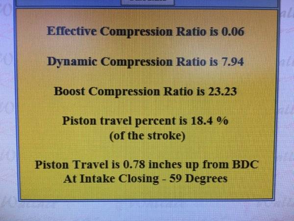

So I’ve calculated my BCR to be 23.23:1 what fuel should I use?

After thinking about it for a couple days, I've decided that BCR must mean Boosted Compression Ratio, and of course DCR is Dynamic C Ratio, and RCR is, I suppose, Regular C Ratio. Is that right??? I had never heard of BCR before, but at 23 to 1, that would mean 23 Cubic inches of fuel/air is squeezed into 1 Cubic inch of space. Kinda like in a black hole. Right? I'll bet that would make a real powerful explosion when it goes off. LOL
Correct, with the exception that the regular CR as you called it is usually refered to as SCR or static CR. This one is a twin turbo combo.
