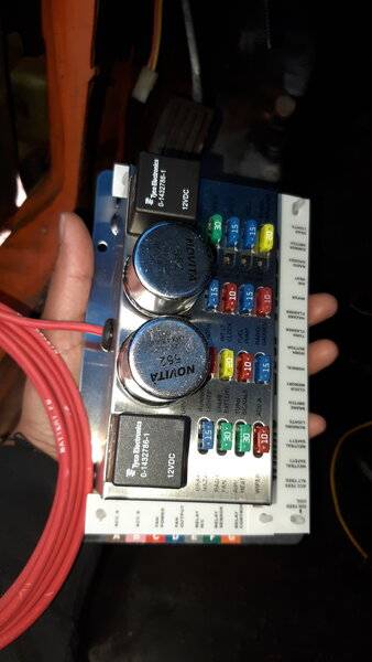

Im installing a Ron Francis kit onto my 69 Roadrunner 4 speed and im looking for suggestions and pictures of where you have installed your aftermarket fuse box
Thank you in advance
Putting a customkit in my 69 RR as well. Welded up most of the firewall holes including the bulkhead connector hole and will be routing the wires out in a less conspicuous location (maybe into the outer wheel well if I can figure how to adequately protect the wires). As for the fuse box, I'm considering the trunk.
I put mine on the drivers side, up somewhere by the E-brake handle...
