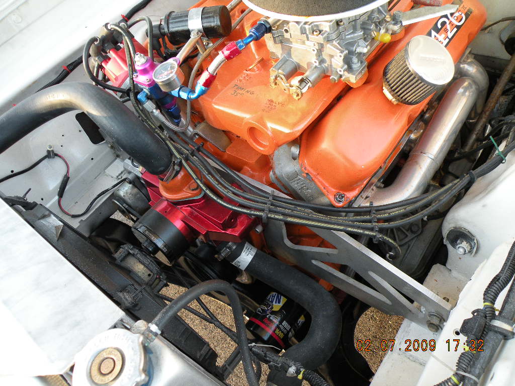

edelbrock performers for me too...440 bored .30 over with 509 lift mopar purple cam..My motor is built for horsepower not torque..Changing my gears to 4.10 next...

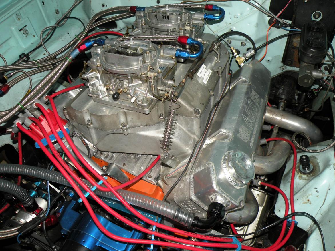

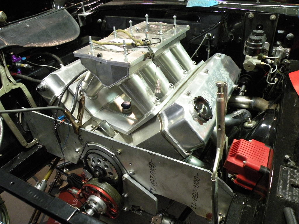

i use indy 440-1 heads, 572-13 cnc 365 heads, indy legend hemi heads 426R-1 and B1 TS Heads
indy heads will out perform most aftermarket heads but they will need some tlc to get them perfect.
I found alot of flaws out of the box and they needed massaging.

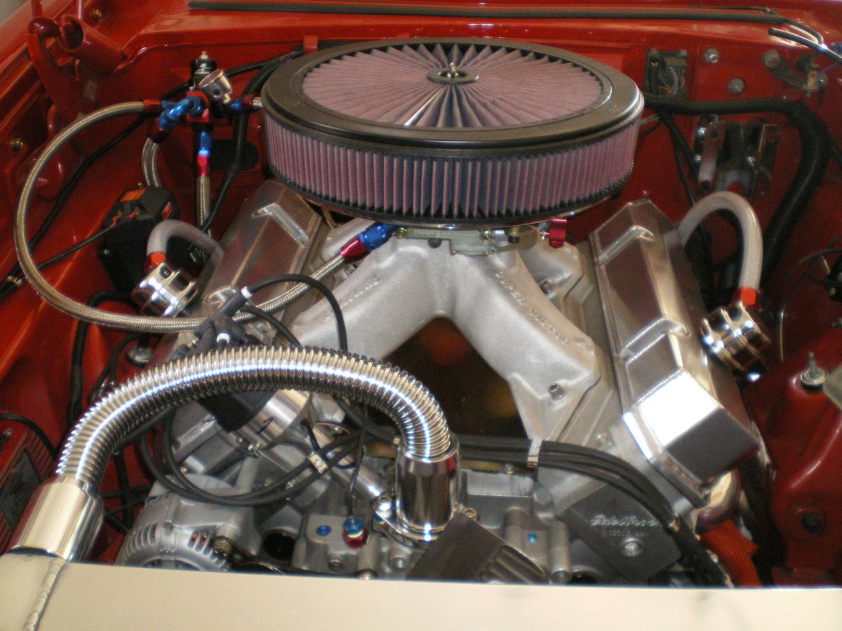

I am running Edelbrock aluminum on a 360 Magnum motor and they seem to be good. How much better than stock or tricked out iron heads - I really don't know.
