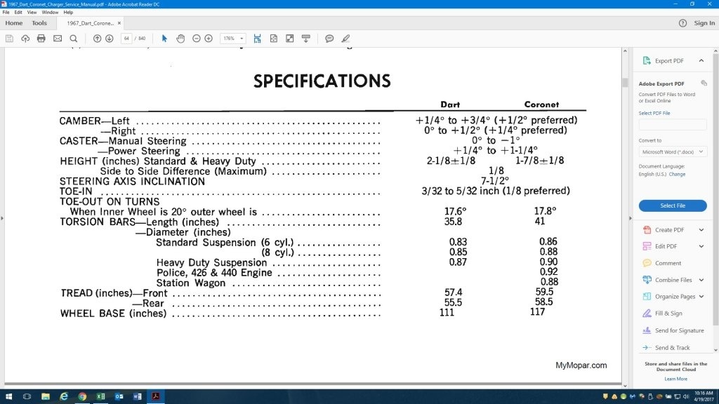

need so specs and info on what to align my 1967 belvedere 4 door sedan
I have power steering now , any light to shed on my situation
I have 14 inch wheels with 225 70 14 bf Goodrich radials
ballpark factory type specs. .5degree's positive camber, 1-2 degrees positive caster and 1/8 in toe in.
what about ride height on the front how high and from where do you measure
Hopefully this helps
67 Coronet is right on with his link: Front end alignment specs from the master himself: Richard Ehrenberg
The biggest diff from OE is camber - positive was for bias ply tires. With radials you want negative camber and as much positive caster as can be dialed in.
Most important - take your car to an old skool shop that understands Mopar torsion bar suspensions.
Disregard factory specs. Try to get as much pos caster 3 degrees, about .5 to 1 degree NEG camber, 1/8 toe-in.
