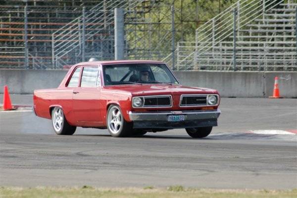

Some of us have had Mopars that handle corners as well
as they go down a straight track, for decades now...
Even with torsion bars...

Very few Mopars came with both front & rear sway bars
I think the T/A's ir also 2" longer wheel base than the cuda'
& also the AAR's were the only ones to get both from the factory
& only with the 340 six-pak/6bbl they also had a
AAR smaller front tire & a bigger rear {15" ?},
it's the Only car they did like that
{I don't actually remember if the TA's came staggered also}
helped to stagger the ride height also &
helped get it to "turn in better" & only a slight bit better,
with a much lighter front end weights
525#'s for a 340 vs 620-670#'s 383-440
Not to discount/forget the elephants {426 Hemi} that weighed
in the neighborhood of 765#'s, pretty hard to over come 240#'s
more/extra nose weight, let alone 95#'s-145#'s heavier/extra
with merely a wedge BB Vs a SBM
The cars with BB's especially B-bodies, still push & under-steer
"like a pig", if you haven't driven something that has far better
IMO that you have nothing to compare it too,
also anyone that's done any autocross, even hard cornering,
hell just merely driving "aggressive" in the mountains
at any rate of higher speed/hell slow speeds or road race stuff
can attest to that fact, regardless of sway bars, yes it helps,
makes it far better, but it's still not the best...
Not without the rest of the components to make it right...
Even the factory E-bodies adding a rear sway bar helps,
"it was a tiny sway bar too", nothing like the aftermarket,
it helped, but that isn't a total cure...
IMO & most the racing communities/engineers all say that,
it's a poor design, for handling PERIOD
Yes some of it can be overcome, buy welding & gussets/plates
it's a lot more than just gussied up OE **** & sway bars
or even bigger torsion bars...
Albeit everything helps, hell almost anything helps,
that's how bad they really are stock...
Some like using the throttle to steer too...
There's nothing wrong with that either...
