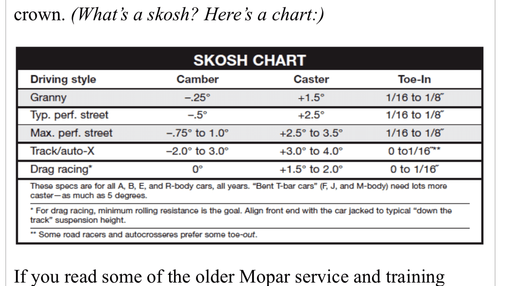

Here's what I used! Got it from allpar I believe
