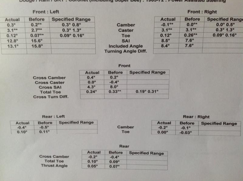

If you can't find one, it's not that hard to do it yourself.
Here's some numbers I think are right...

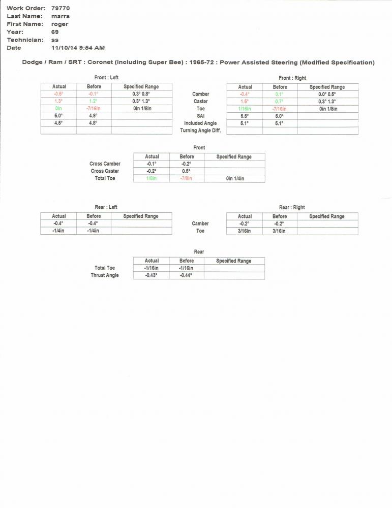

Steering angle....? Are you referring to Ackermann? Kinda hard to adjust that unless you start playing games with different Pitman/idler lengths, isn't it?Numbers on that chart are simply a guideline...one size fits all.
If you can look in a service manual for your Dodge (69?), just as for any other Mopar front end, there's other adjustments that should be checked...such as steering angle. All is a waste of time, if there's too much wear on bushings, and such. But, a good shop will know what to look at, and what needs to be done.
All hand over fist stuff. Either right, or wrong. That just means a good go through on it. Should get you fixed up!
Only upgrades up front for me are the Cooper radials and Bilsteins. Nothing else. Firm Feel not in the mix I guess.
