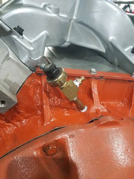

Just got done putting a tee in one of mine. Easy when it is out of the car of course, but I have done several with the motor in the car as well.

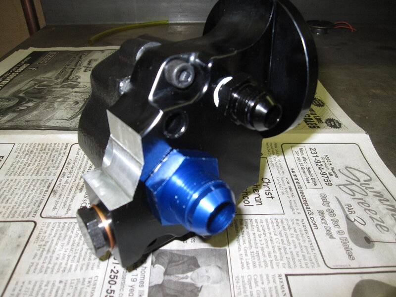

Not trying to step on this thread, I drilled and tapped the Milodon pump cover on my 540 to hook up the accumulator I'm installing. I wanted a larger opening. Top fitting in photo. Had to mill out the corner for mount clearance.
Mike
The tap on the back of the block shows that there is oil pressure in the engine. A tap on the pump only says there is pump pressure there...

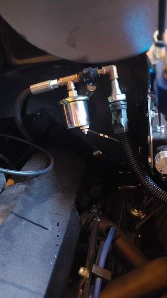

I moved mine via a hose connection at the block
and mounted the sender and switch
to the firewall. This is on a 440 with a 1940
Plymouth truck cab.
