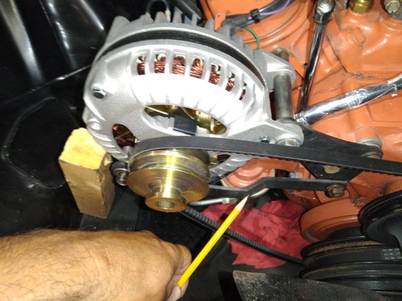

I just replaced the alternator with a Powermaster round back (68 Coronet w/ small block). Because the PM pulleys are a smaller diameter, I cannot tighten the belt. I'm at the end of travel on the brackets slot. Do they make a bracket with a longer length? Or can I use the other mounting hole on the water pump bracket? Any thoughts?
Shorter belt????
Ya know... sometimes I forget what a dumb *** I can be when I really try. It's times like these I wonder if my pot-smokin' days have finally caught up with me. Thank you sir.
I just replaced the alternator with a Powermaster round back (68 Coronet w/ small block). Because the PM pulleys are a smaller diameter, I cannot tighten the belt. I'm at the end of travel on the brackets slot. Do they make a bracket with a longer length? Or can I use the other mounting hole on the water pump bracket? Any thoughts?View attachment 1682872
Just measure the existing belt's CIRCUMFERENCE (or pitch diameter if you prefer) and consult Gates or Dayco application charts for a belt with 2" to 3" SHORTER CIRCUMFERENCE or pitch diameter (with same width as origional belt)......no welding or fabrication required.

Or take the old belt to the auto parts store and tell them you want, then compare old belt to a shorter one.
Do you need a dual groove pulley alternator?
I only ask as the Vee centre is different if using a single groove pulley.....belt alignment is very important. :thumbsup:

The original was a dual groove, as Nadine was born with A/C. The A/C is gone now, but I stuck with a dual groove anyway... so we should be good there.
Here's a crazy thought: are big block tensioning brackets the same length as the LA brackets??
