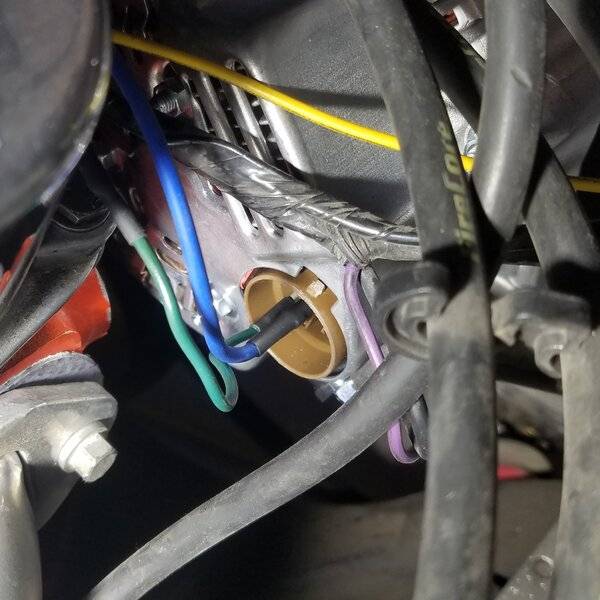

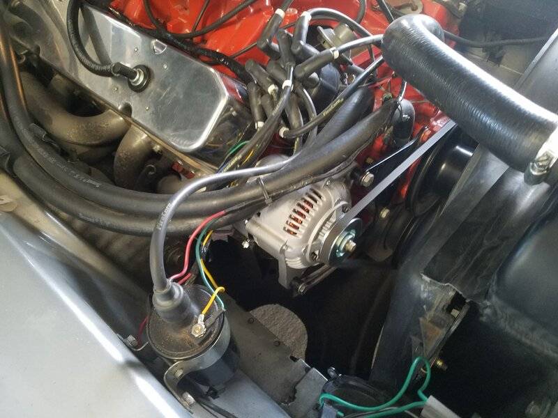

I just swapped my old one wire alternator for a Denso alternator and it was a simple and very worthwhile upgrade. No lights dimming at idle. Puts out 14.3v at all times. It is internally regulated so you can bypass the old VR.
I had already done the MAD upgrade and installed relays for the lights. Anything to take the load off of the bulkhead connector and old switches is worth it.

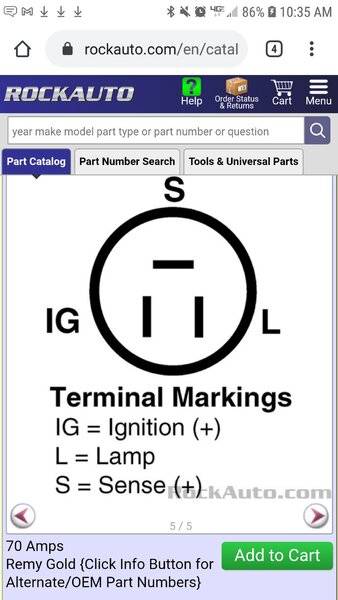

Wiring was simple. I had to run an alt sense wire directly to battery. The other two alt wires were reused.
Original brackets are perfect. I only needed two 5/8" spacers.
