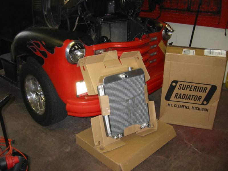

I have a 1965 Dodge Coronet with a 528 Hemi. After much research and decision making. I'm having one made by a company local to me called Superior Radiator (586)463-8722. A lot of people here in Michigan swear by SR. They are a true handmade, aluminum heliarc radiator that works the first time, fits correctly and keeps your car running cool at a good price. Griffin radiators are epoxied, are a one size fits all radiators and cost more. In fact, SR repairs a lot of Griffin radiators, yikes...
If you are not to picky about a non stamped factory looking tank which I am not. I would give them a call. After seeing what they have and seeing there finish products, I feel no one can compete... Looks pretty stout and badass...:eusa_clap: Just my two cents...

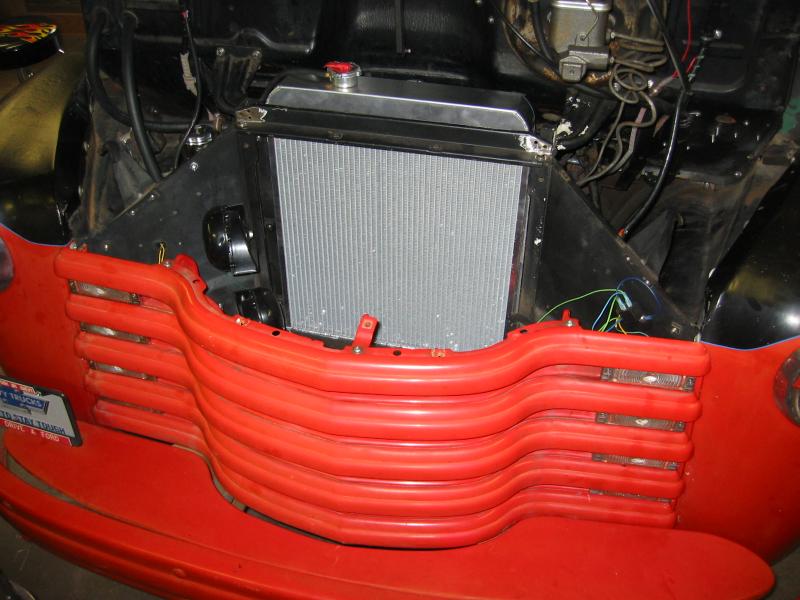

Just put a Superior in my COE - very happy too.
http://wwwsuperiorradiator.com/

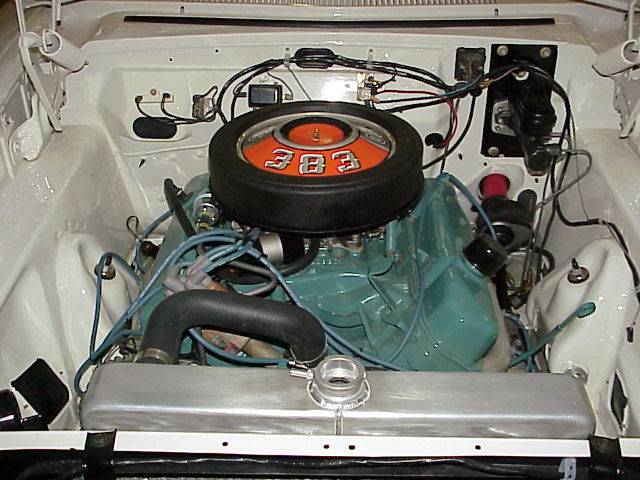

Here are a couple shots of my Griffin back when everything was new and sparkly under the hood:
Wish the motor & fenderwells still looked that nice!

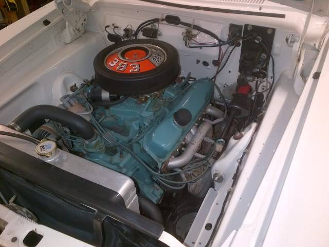

Here it is today. The hood seal really does a good job of minimizing it. If it were painted black, half the people would never see it

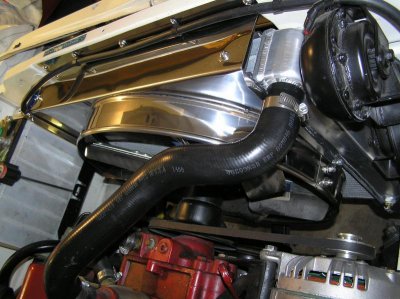

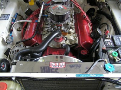

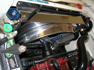

I have a '64 Dodge Polara 318 poly auto. I went to the Summit site and picked a generic alum rad that was the biggest possible for my space. I chose a SUM-381425 for $189 (in '09). The connection on the top tank was on the driverside instead of the middle. The lower hose connection needed to be angled differently. It didn't have a drain spigot so I had one installed and I had some alum studs welded to the bottom for mounting. All the mods added $100 to the cost. I then had a friend build me a custom mirror stainless shroud. I have a large B&M trans cooler separate from the rad although the rad has a provision for trans cooling. It has worked well for me. I know it's more work than just buying a custom made unit but it was just around $325 which is considerably cheaper than the alternatives.
