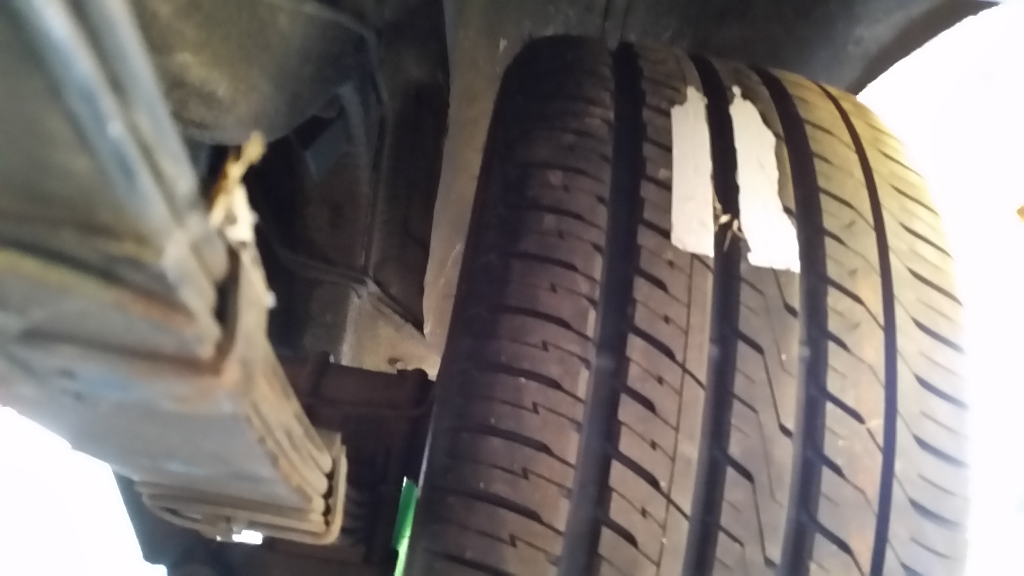

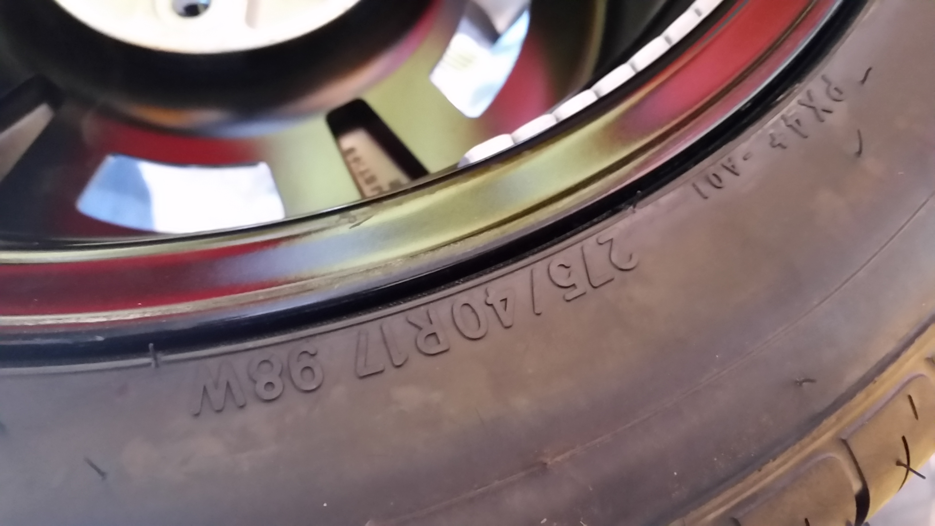

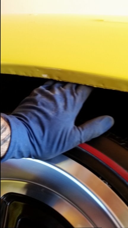

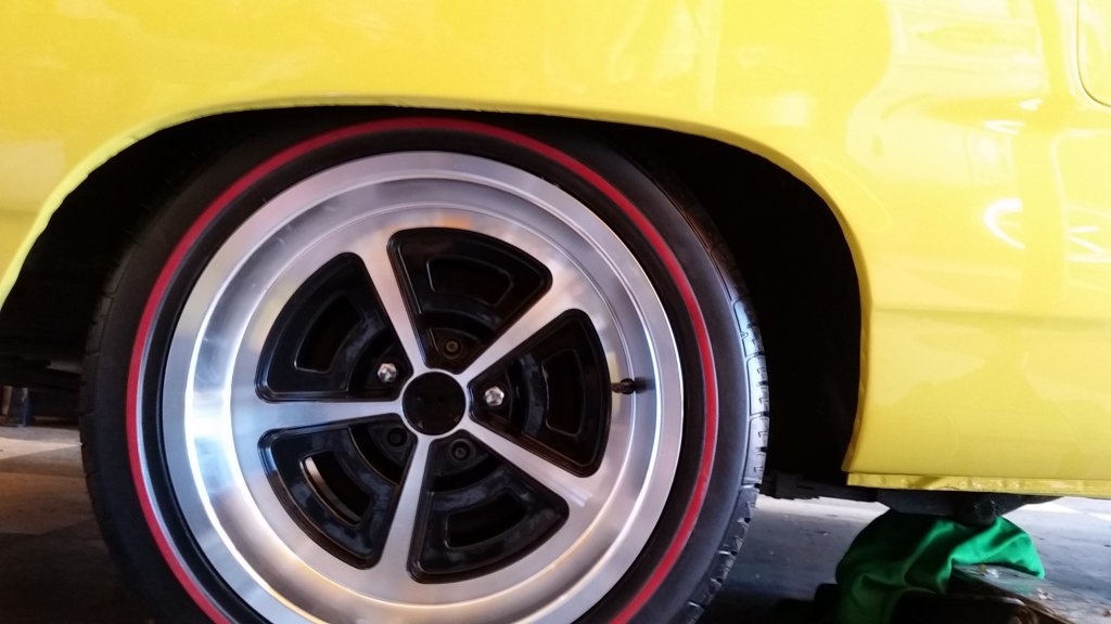

Give me the weekend and I will tell you what I find. I have a set of year one magnum 17 inch I am trying on the 70 v code car.

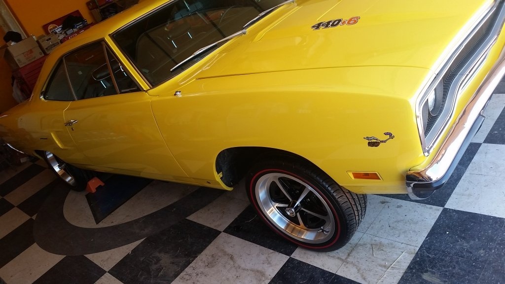

Here is the 15 inch right now. Later today I'll go to storage and get the 17 inch wheels
I have tons more pics just I'm me your number I'll text them to you. This new forum is too cumbersome on my phone

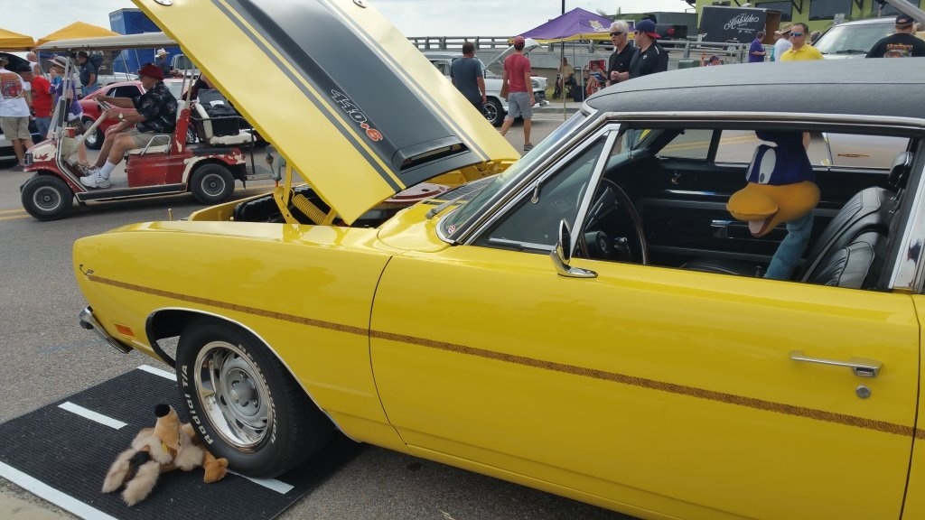

When I still had 17" on my car it was 17x8 front 17x9 rear. 255/50 Nitto 555 front. 28x9 Hoosier slicks rear. 295/45 MT ET Street fit nice on a 17x9 and are DOT.
Radical! Looks great! Beautiful car! I had a yellow and black 71 Charger R/T back in 78-79
Thanks!
Never heard from you hoped this helped
I could have went to 295 in the rear I'm sure
