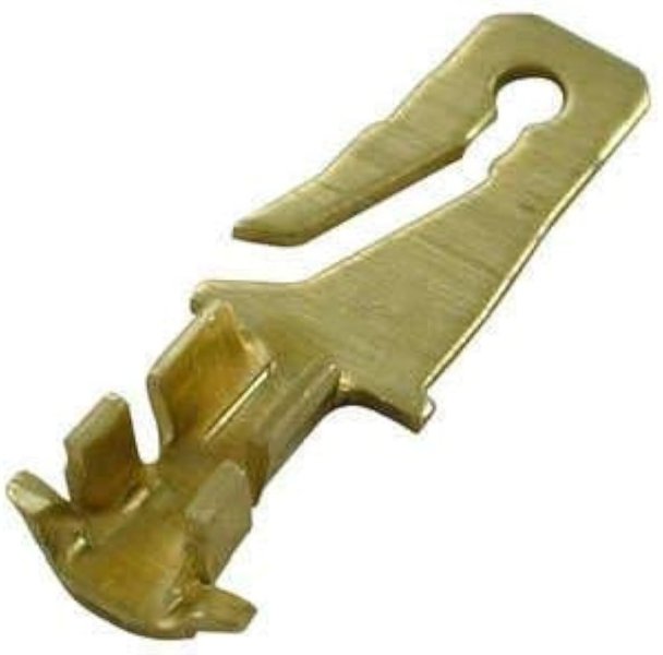

Oils you tell me easiest way to get off the fusible link from harness
I assume 68 is pretty much the same as 67. On mine, one end of the fusible link has an eye that is attached to the starter relay. The other end has a male terminal plugged into the engine-side bulkhead connector. Unplug that harness connector from the bulkhead. You should see the male terminals protruding inside the connector. Gently squeeze the 2 sides together with a needle nose pliers and push it out of the harness connector. The new one should snap in.
