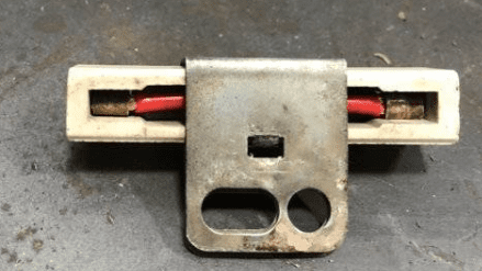

View attachment 1650120 Yepper ..... That's the way to do it. You can't tell from stock.I did this very same trick, jumped the back posts. The Pertronix coil can now receive 12 v. I had replaced one on something and kept the old one and , walla, a freebie to modify, looks perfect.
