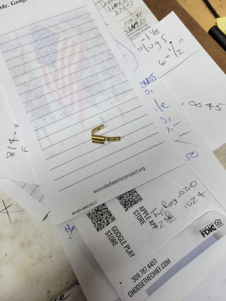

Purchase (2) of these connectors, install (1) on each terminal of ballast resistor. And next make a short cable with female tab connectors and jumper the ballast resistor. Note that this method will retain all of factory wiring, no cutting required so U can return back to the origional OE wiring layout if ever desired. The connectors are available on line or from Napa.

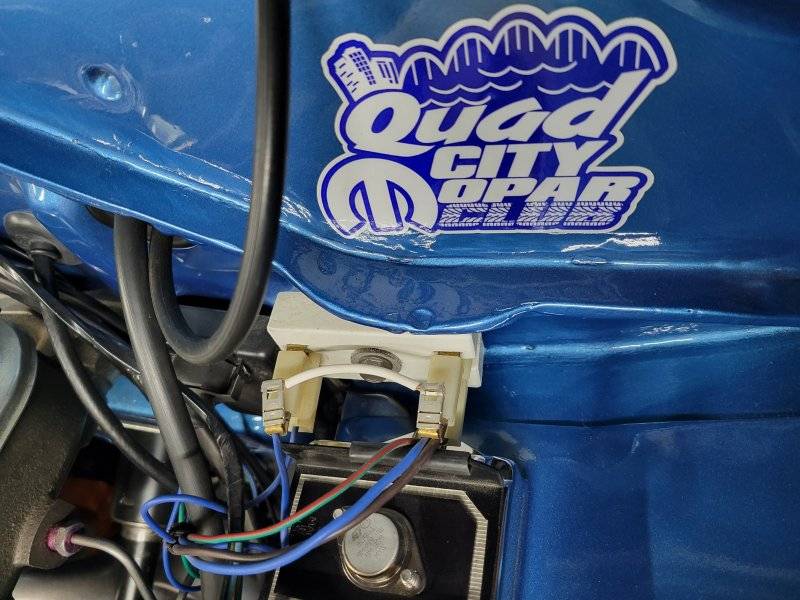

I'm not concerned with a purely original look. I took both the blue & brown wires, coming from the bulkhead disconnect (big bunch of wires & 3 big plugs on firewall), that go into the ballast resistor and splice those two together + also splice in the blue wire coming out of the ballast resistor. Then you can just remove the ballast resistor

Yepper ..... That's the way to do it. You can't tell from stock.

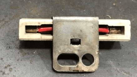

Gut it, solder in a wire, re-install. I epoxied mine after I was done otherwise the wires moved around.

Yes, hiding the wire inside the ballast does make it look like you didn't do that. Will next guy know that, if he changes something? Yeah, don't worry about the next guy. I do like it, it's just that you are the only one that knows it.
I have a gutted ballast, petronix coil, got a dry transfer to add oem writing to the coil.

Very simple... for a Pertronics conversion, just remove the resistor, solder in a solid insulated wire from one terminal to the other in the back side, then re-install. That will maintain the stock look. Make sure you replace your coil with one compatible with a 12 volt system.
