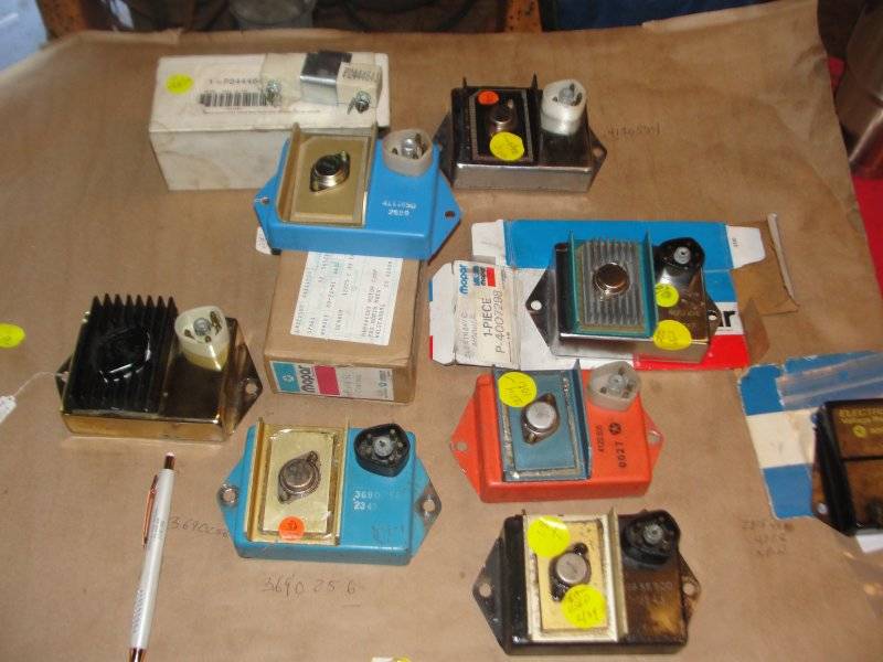

OK thats funny high fail rate look at them even a "fake" transistor. One of the reasons they fail. Long but beats up the ecu's out there. once again "Mopar authorized."

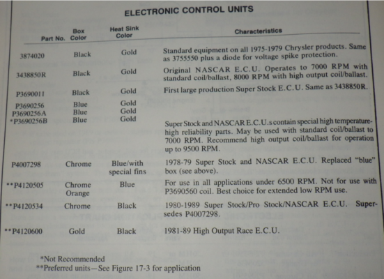

So printing on the transistor is good? Also what is the difference between the orange and the Chrome and are they reliable?
Yes look at the link. RPM is the difference with the right rated ballast resistor.

Around 2000 the orange boxes went downhill. Big clues are AUTHORIZED or REPLACES on the sticker of the MP box. Biggest fail of the real boxes is mis matched ballast resistors, seriously!

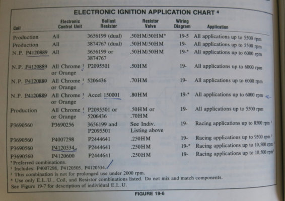

What ballast resistor should I run with The Orange box. Not looking for high RPM, just reliability.

Who's orange box real Mopar authorized or a box just orange? Usually one ohm to be safe on the street. Not knowing which coil you have.
Man need a pic and which dist? I forgot.
