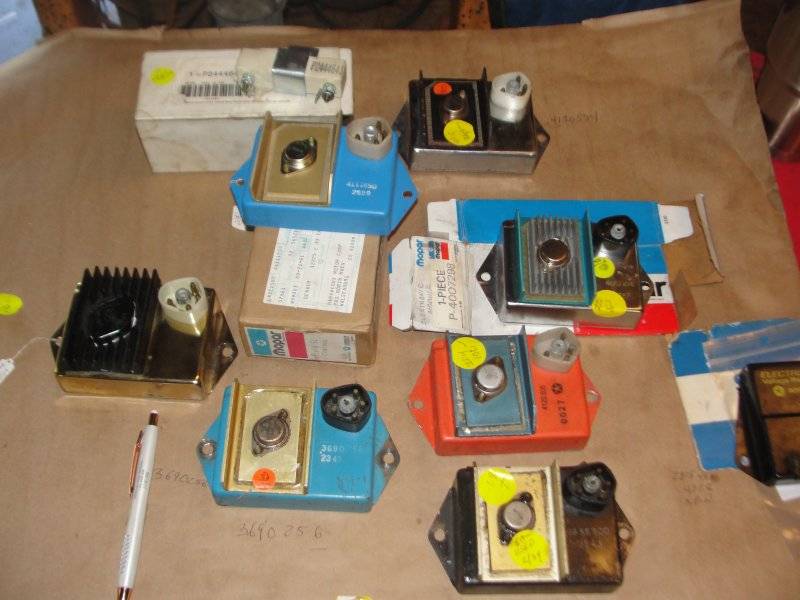

I think your 1st statement is for the MP
Gold Race Box, 'not the Chrome box'
the chrome box is just a upgrade over the orange box, for better HP/street-strip use
that
"Gold" Race Box is not supposed to run for over like a 1/2 an hr continuously,
intended for sort intervals like 1/4 mile track usage & uses a special coil too
been that way since the 70's. Pro-Stock era
but I could be misspoken/mistaken
I had one (2005-ish MP Chrome DEI Ignition Box) on my RR for almost 19-20 years,
drove everywhere with it, no hot start issues, no failures, (5pin or 4pin)
has several of them on several different MoPar over the years, same set up, same results
later 4-pin style Ballast Resister even etc., you do need to ground it/box well to the body
& have good chassis/body grounds to the engine/battery too, or they won't work very well
on any CEI Box
I also have an NOS' MP Gold Race Unit too (same era MP Unit late 90's early 2000's),
they have a 'real' heat sink under/around, the "real" transistor
I tried it out, made sure it worked, then took it off & put it back in the box...
before I went to an FBO unit

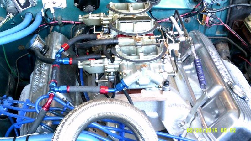

you can barely see it/MP Chrome box
to the upper left/cut in 1/2 by the shitty photographer
I'd go out & take photos of them, but it's snowing & cold outside now
even if it's in the garage... I'll stay in where it's nice & warm thank you...
if someone really needs it, I can go out & find them, take the photos
carry on

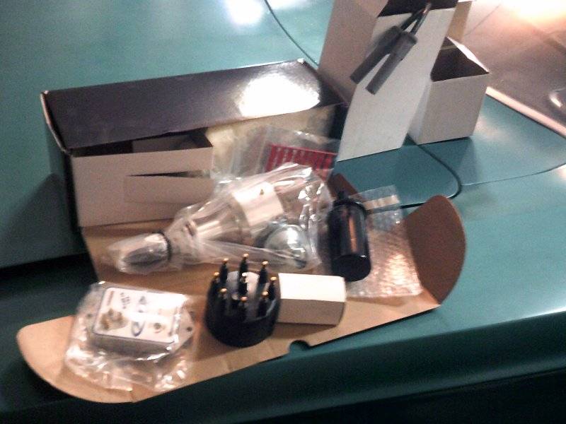

I now have Firecore dist. (plug & play) & FBO Box w/rev limiter, full 12vlts & low ohm Pertronix coil
Hei-style male cap, good combo of Summit 90* 40ohm res. & E3 180* 40ohm resistance plug wires,
DEI wire shields, bypassed the ballast for a full 12 vlts, otherwise, it's plug & play, & a hotter/better box
