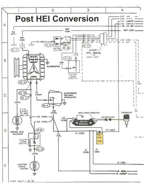

I did something very similar to my '74 SE 400 a few years ago and it has worked flawlessly from day one! I was advised to pair the GM module with an "E" Core coil and the result was the hottest spark I've ever seen. I opted for this one... Speedmaster Ignition Coils PCE382.1030.
I know the OP does not have an original MOPAR distributor and believe that is required for using the CNC fabricated adapter plate offered by one of our members; allowing the GM module to attach underneath the distributor head. I wish I could recall their name. Hopefully they will speak up. Don't see why mounting it like in the video would not work. Looks a little rough but "function before form" ya know.....

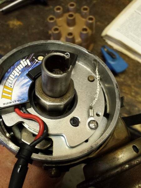

I have been useing the same pertronix conversion for over 10 years.
Had it on 2 different big blocks, new cap and rotor every couple years.
Each engine , 383 and 440 I went both times to Orielys and ordered a rebuilt points style distributor add the pertronix.
Swapped in my #9 limit plate and light springs.
I have been useing the same 1.5 ohm flame thrower coil from the start.
Wired around the ballast.
It is a good system.
I know the OP does not have an original MOPAR distributor and believe that is required for using the CNC fabricated adapter plate offered by one of our members; allowing the GM module to attach underneath the distributor head. I purchased a distributor from Rock Auto cheaper than I could find a OEM unit and had to drill and tap the required mounting holes-no big deal. I wish I could recall their name. Did you read my #17 post? Hopefully they will speak up. Don't see why mounting it like in the video would not work. Looks a little rough but "function before form" ya know.....

Haven't read the posts. Dump the Chrys box & use a $30 GM HEI pin module with your Chrys dist. Wiring diagrams on the net. If you want to splash out a few more $$$ on an E core coil, you can ditch the bal res, another failure point gone. Run 0.060" plug gaps.

Post #37. The HEI is very reliable as long as an adequate heat sink is used. It has less external connection points than the Chrys system, & each one is subject to failure from corrosion, loose connection etc.
