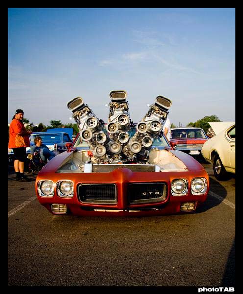

:headbang:
He can afford 2 blowers and an Auto Meter dash, but refuses to spring for some spray lube for the door hinges. Typical Poncho owner.:happy7:
I thought that was funny, too. Sounds like a old truck when the door opens. lol
