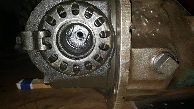

OK . Reading the paper work from Dr Diff. " 8 3/4 clutch sure grip powr- lok
Includes upgraded 30 spline side gears
NO BUTTONS
So when I pull the axles and looked inside , I could see through a small hole
That must mean there's no thrust buttons
No button...
If no buttons, the axles should tighten right up as there isn’t anything to stop them.
Button head are around 1/4" thick. That means there no way the adjuster can work.
Looks like you have to pull it back out and install the thrust buttons or go with the Green bearings.....
By putting. thrust buttons in wouldn't that make drivers side stay out that 1/8" I'm trying to get rid of
When you stick in the driver's side axle and bolt it down, then install the passenger side, you adjust it to butt up against the thrust pin then back it off for a little bit of cold clearance. When this is done, the 1/8'' play that you have in the driver side axle should be gone except for the .010 or so clearance.

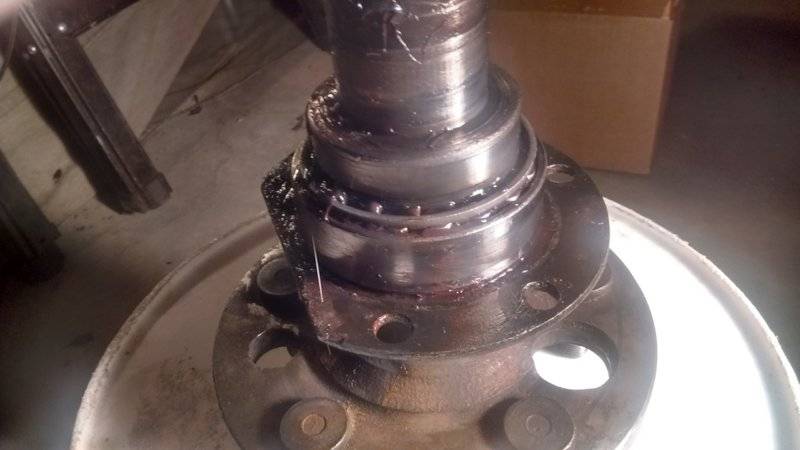

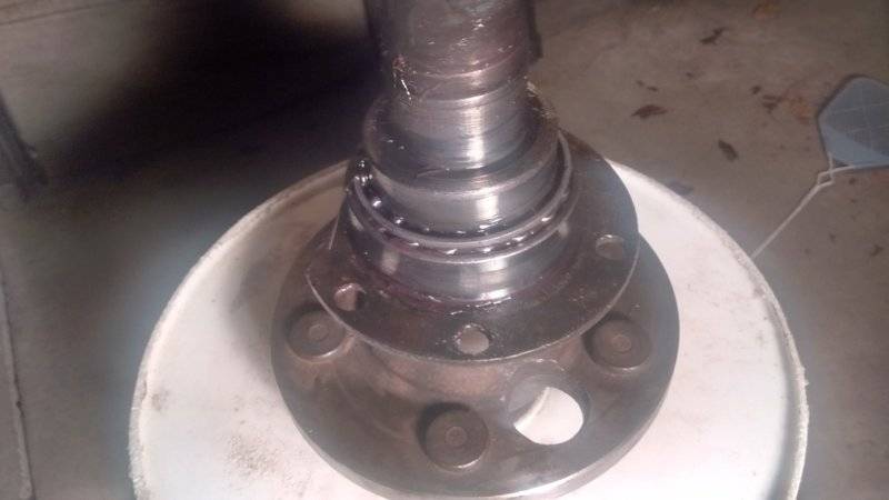

Thank you , right from the manual. I think I have other issues. There are no thrust pins and if my bearings are OEM I'm doing nothing.These are pictures of what I have.
Okay I'm late getting back, these guys are right on...that was my meaning earlier, if they never tighten against each other (zero clearance) even when the adjuster is all the way down, the thrust button is gone/out of place. You can't get them tightened enough without it.
What is that round clip thingy on top of the bearing?
