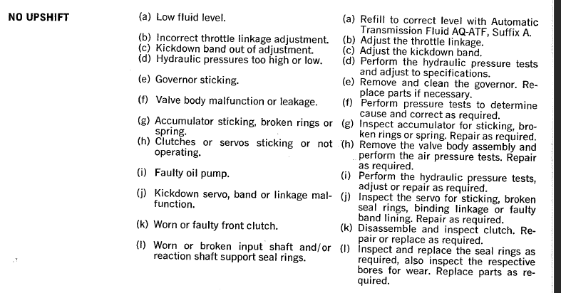

I assume you have low and reverse? The post is out of the service manual. It's a process of elimination. See if DVW chimes in he is very knowledgeable.
Yes, low and reverse are good with no issues. Thanks for the check list, but I'm looking for the "most probable" cause of the problem, excluding those that I've already checked as mentioned in my OP. Thanks again for the input!
I had the same problem it was h on the list. Go My Mopar and down a service manual. There is an air test if you remove the valve body. It works some of the internals. The h is down on the list. dvw should have some input on this. 2/3 clutch pack seal small crack in it. Could hear it leaking when I did air test, see service manual.
