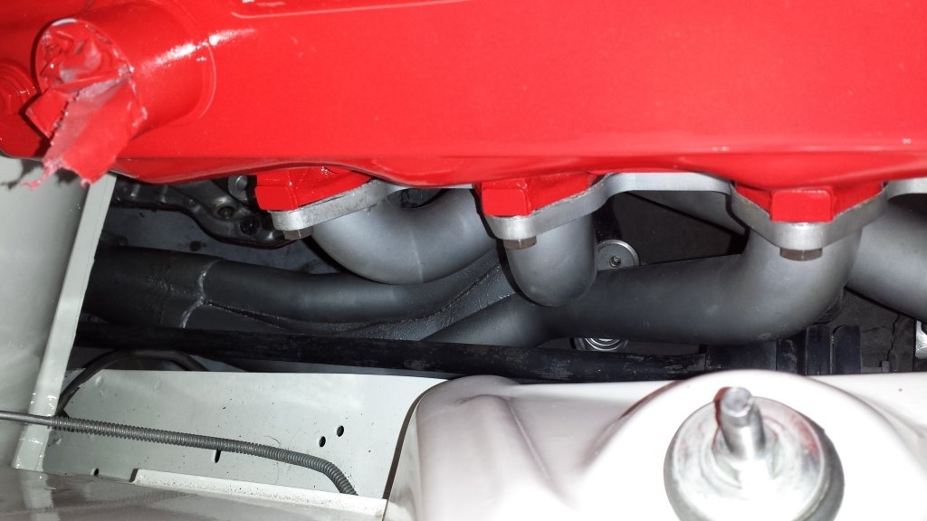

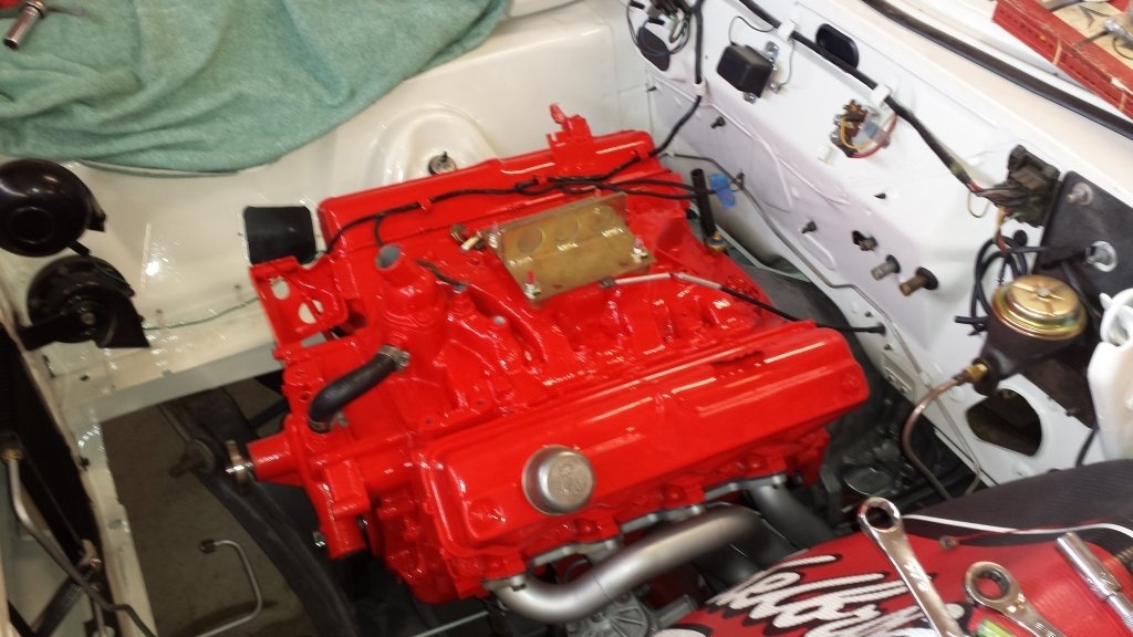

62 Dodge with TTI Max Wedge. 3 inch. 383 Engine

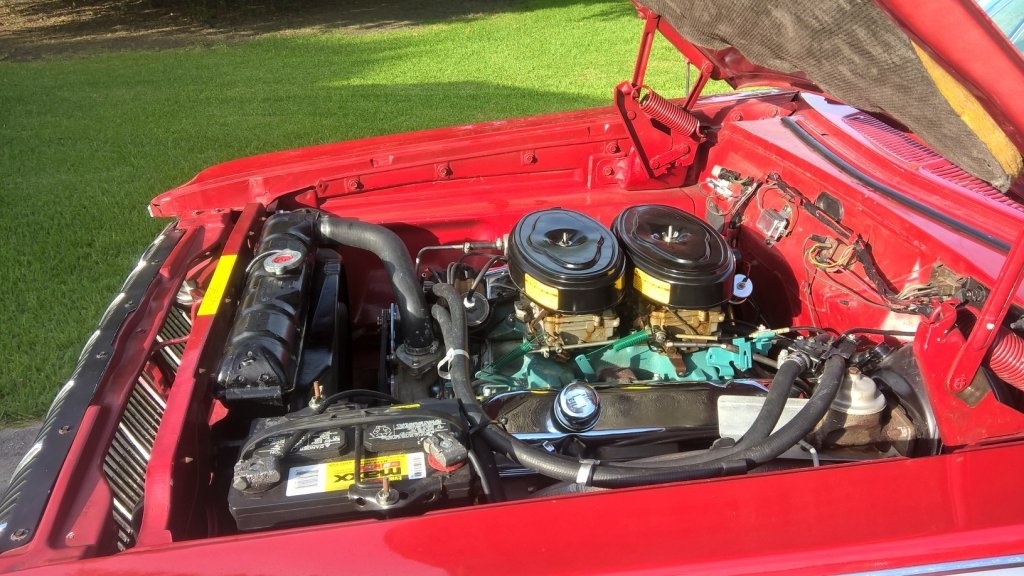

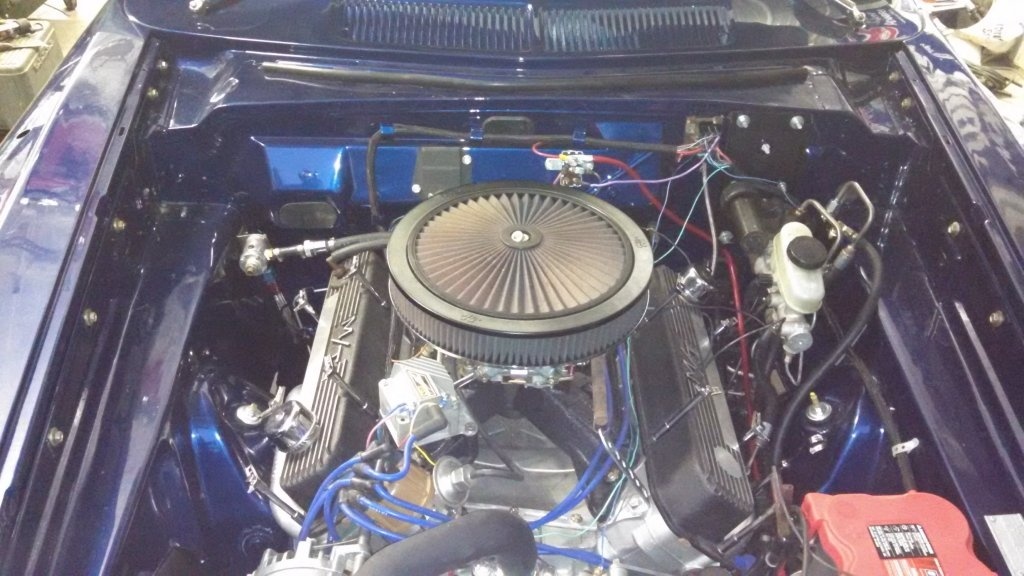

My 62 with 318 Poly, TTI headers, 2 1/2" dual exhaust. The driver side required a few modifications to some nuts and bolts. Used an allen head on a few with limited access and ground down a nut to get it on a stud.

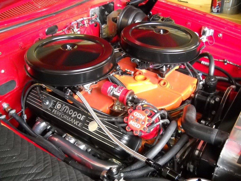

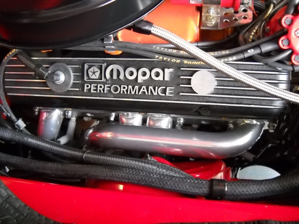

My 63 Fury, similar engine bay: 426/440, Doug's headers, 2.5" exhaust.
