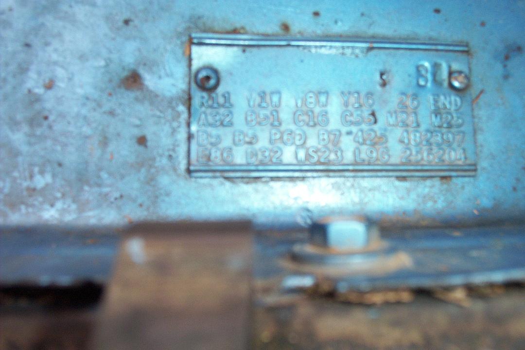

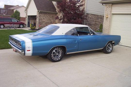

My 69 R/T was a factory dana car with an auto. I believe in 69 it was a track pack car as opposed to the super track pack car of 70. I think I have the tag? I believe A32 code IIRC? Not really an option, but a axle package.

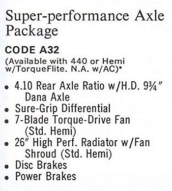

The A32 Super Performance axle was available in 69-70. In '71 they called it the Super Track Pack.
You got the 4:10 Dana behind the 440 or Hemi with Automatic. Available in B and E bodies. It's not a common option but you can find it out there.

I took the question as just ordering a dana over a 8 3/4, not getting a performance axle package.

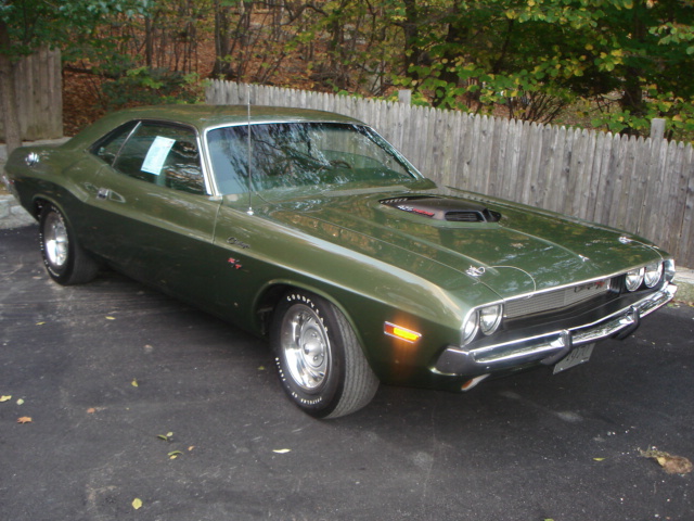

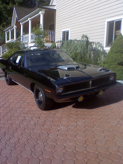

my 70 hemi challenger and 70 hemi cuda were both factory automatics with a ordered dana 60 rear.

Yes, but both of them were axle package cars too weren't they???

My purpose was only to shine some light on this combo auto & Dana that is not that common. From this thread I've already learned ( as I suspect others too now) that the A32 package netted the dana and 4:10s plus the additional items. I realize we'll never get a real number about how many, etc., but the guy that ordered that combo was out to do some serious racing...makes it pretty interesting to me. We also know the A32 shows on the fender tag, which sometimes varies by production plant but you never know if others also have grease markings or other documentation. This thread has been answering my question...thanks

YES.both cars had the axle package w/4.10 gears.:sleepy2:

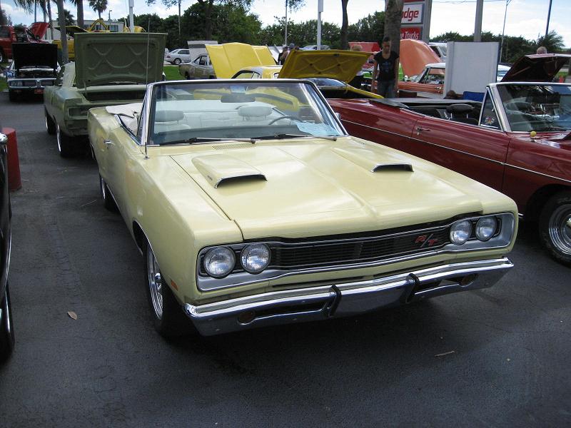

Here's a rare one. 69 Coronet R/T vert., auto with the A32 package and power windows! Wish I had the $$$ to make a deal on it!!
