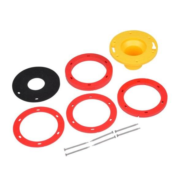

Been there.. Done that. Stacking wax rings will get you by, but is not a forever fix. The extender kit is the way to go. No plumber required. https://www.homedepot.com/p/Oatey-1-4-in-1-5-8-in-Toilet-Flange-Extender-Kit-43400/305537804

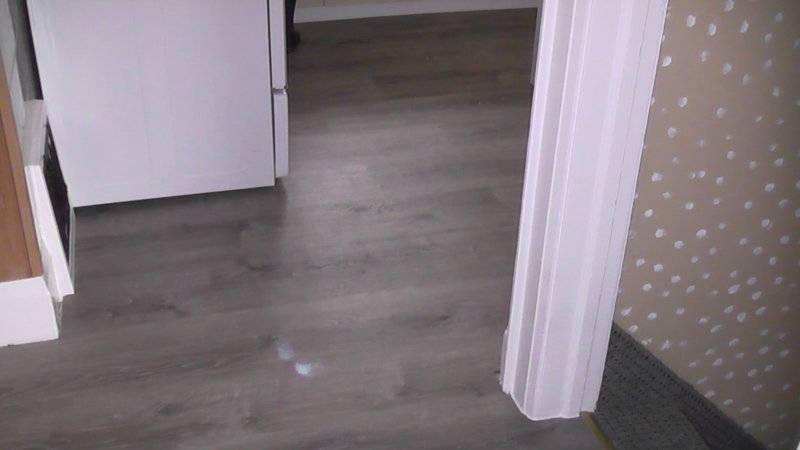

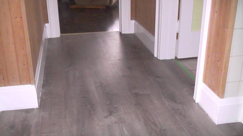

Well it 3 days old,its ok,me i like the real things in this world,never a fan of fake,but it did go down well,took 10 hours by myself,i put over ceramic tile,hence the flange problim.the bathroom is next,going with a different color.7mm is good anything else is too thin.it helps that i am a carpet installer by trade.the joints are tight.

There are three key points to my discussion about resetting the closet on an existing flange, which is too low. 1.) the existing flange must be fastened well 2.) the "squish" and 3.) Caulking down. Caulking down is both needed for holding the bowl tight, especially on a tile or harder floor surface, and it will also create an excellent visual aid if the bowl does become dislodged by an over weight or overzealous user. If there is never any movement, there will never be any problem with the wax seal, ever. Two problems I see with the Home Depot kit pictured are the need to seal every needed layer of the shims separately to each other, as well as to the existing and the new top flange. Also, the new top flange is crappy plastic, and will inevitably allow movement and seal failure anyway. Good Luck, Lefty71. BTW, not the kind of pedigree I'd brag about, but you can bet I've been around long enough, I'm not gonna screw up setting water closets and have to go back and redo those jobs. I know my methods are solid.
