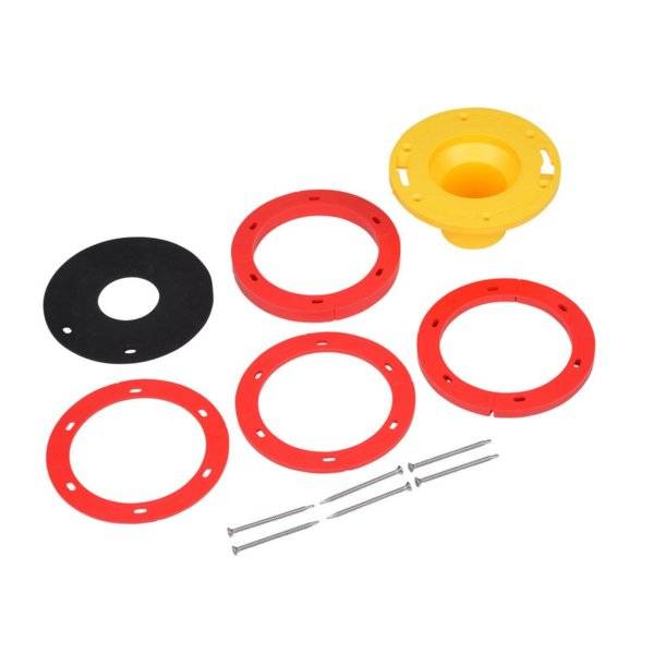

View attachment 727390 Been there.. Done that. Stacking wax rings will get you by, but is not a forever fix. The extender kit is the way to go. No plumber required. https://www.homedepot.com/p/Oatey-1-4-in-1-5-8-in-Toilet-Flange-Extender-Kit-43400/305537804
Nothing is a forever fix in the toilet floor gasket area. The oldest gasket I removed was a Asbestos gasket ring from pre WWII. Come to think of it I haven't dealt with a toilet with a 2'' elbow between the tank and the bowl in some time. Drawing up that 2'' spud was a stressful job.
