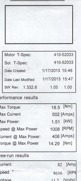

Attached is a real dyno test sheet of my starter. This is what I received with my J&N mini starter last year. You will notice that it shows kilowatts (kw), torque, amps, speed and voltage. These are all the parameters needed to determine the performance of a starter. The video missed most of these components.
This is a 1.4kw mini starter for a 1990's Dakota. Its the one with the higher gear reduction as compared to the 80's Diplomat starter. You will see in the data that the starter pulled 408 amps around rated kw and on their battery it was at 1001 rpm and 7.93 volts. This dyno sheet does not paint a 100% picture, but is MONUMENTALLY better than that video. Not sure the torque rating of the starter but I think its around 14 Nm. I have that data somewhere. Max power was achieved at 408 amps and 7.93 volts.
