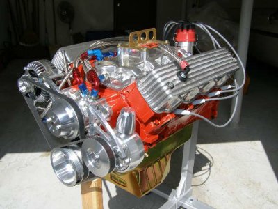

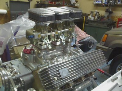

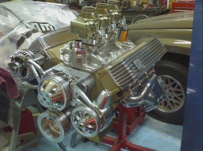

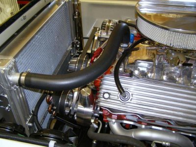

Mine has been built for a few years, waiting on the car (63 Fury ragtop). Gary was my guru. Bored .060 over, 4" Eagle stroker crank, Eagle rods, Ross custom pistons, Racer Brown cam (ST-14 I think), ported heads with larger valves, valve covers from Gary, Edelbrock intake with 3 demon 98 carbs, March brackets up front and March P/S pump, TTI headers, Milodon pan

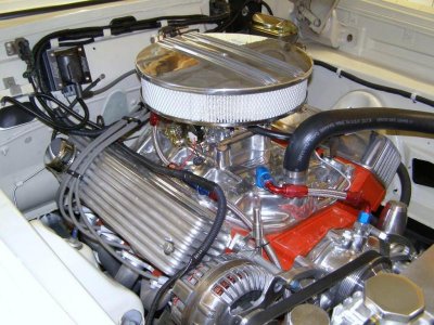

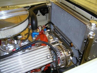

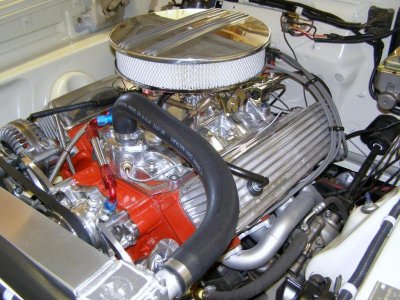

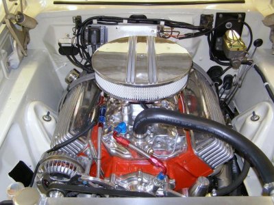

My Poly stroker has been in service since Sept. 2010, no regrets!
359 cu.in. 392hp @5700, 392 tq. @4200
4" bore +.090, 3.58" stroke
Callies...Dragon Slayer 3.58" stoker crankshaft
Crower...forged rods (modified chev. 454)
CP Carrillo...forged aluminum pistons 9.5cr
Racer Brown...ST-14 solid lifter cam, 266* .486" lift
Howard...pushrods
REV...stainless steel chrome tip valves 1.96" int. 1.60" exh.
RAM...blueprinted heads
Weiand...7503 intake
Mallory...57 Breakerless Magnetic electronic distributor
Mallory...30440 coil
Scott...plug wires
NGK...R5670-8 V-Power Racing plugs
Milodon...Pan, pick-up & pump, dipstick
March Performance...Pulleys & brackets, PS pump, 100amp Mopar 1-wire alternator, Gates belts
BHJ...Damper
Lake...Timing cover
Edelbrock...water pump, fuel pump
TTI...Headers, 3" Max Wedge exhaust X-pipe, Spin Tech Sportsman XL mufflers
Howard...pushrods
Scott...plug wires
BHJ...Damper
Lake...Timing cover

this motor must have 30 over 340 pistons in it.........that's the same crank we used in our dirt motors to get 358ci......Artie
