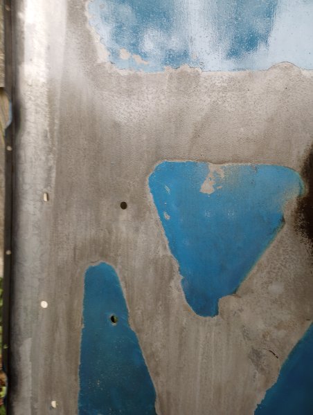

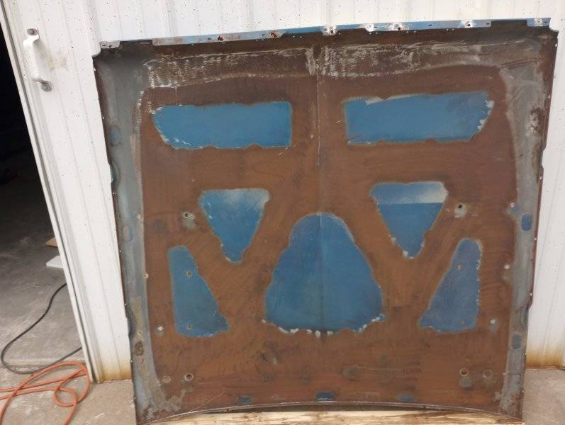

fill it with molasses and water for a month?
View attachment 1633910View attachment 1633911
