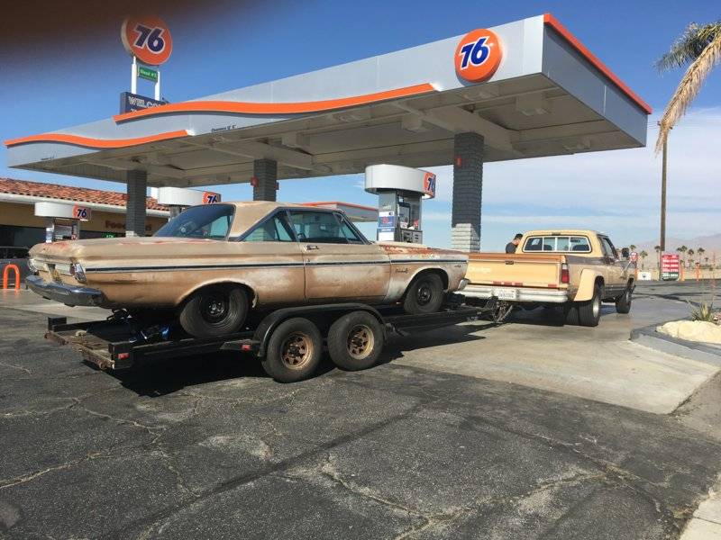

I’ve run my car a bunch of times at irwindale last year. It is heavily patinaed. Faded gold paint with red primer showing underneath. This look familiar?

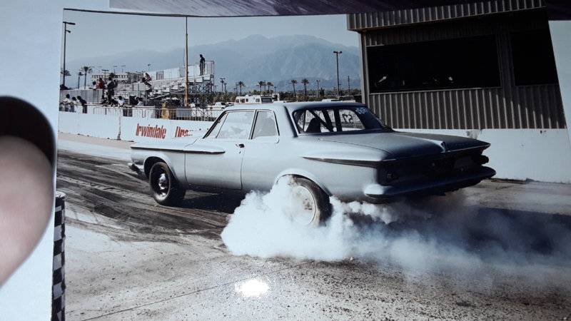

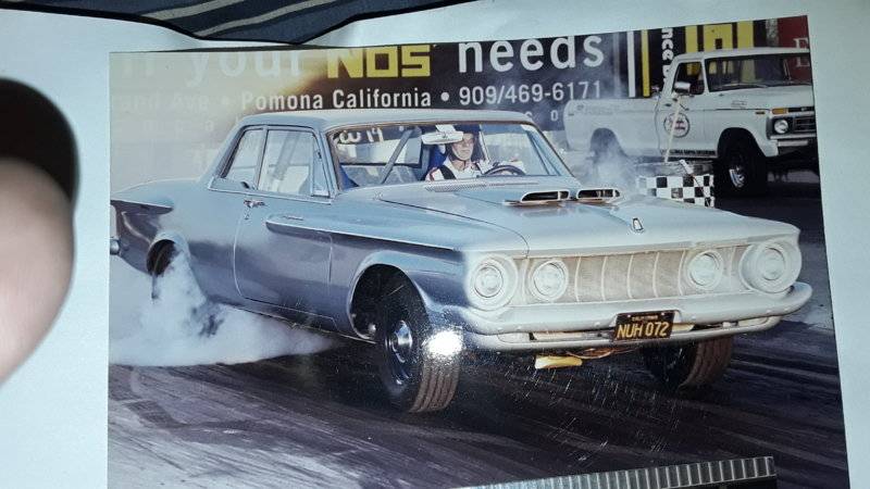

Hosehead , i have seen your car at irwindale! Next time i see it i'll introduce myself!
(Irwindale will bounce for going too fast, but you really have to rub their noses in it. The one i remember was an izzys performance 1/2 ton standard cab chevy, with a twin turbo 427ci ls. It went6.0?/ 130 with a lap belt and no bar! Got thrown out before he could turn onto the return road!)
They gave me a little grief about going 6.30s without a license so i just started short shifting and shutting off a little early, and they let it go.
Yes! Please introduce yourself next time! Us mopar guys have to stick together out there!
