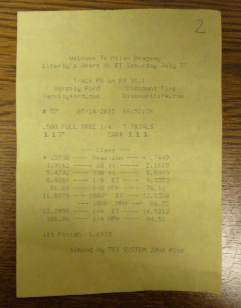

I got in 6 passes total. Here is the one I think is the best. I am car 111.
The other ones were all pretty consistent with ETs in the 14.6 range and speed in the 94s. That's about what I was expecting based on how the car felt before.
Running it at Milan was very enlightening. It seems the biggest performance issues I have right now are:
1) Trans not set up properly. It's shifting at 4400 rpm and that's killing me.
2) 3.21 rear axle ratio.
3) Could use more traction.

However, going back to my earlier comments, last night I took it back to the shop that rebuilt the trans. They said they can get the WOT shift points up to 5400 no problem. We'll see how that does. Also got a self-locking trans dipstick so no more spewing trans fluid all over the track.
Item 2 was the rear axle ratio. It had 3.90 gears in it when I got it and that sucked on the highway (70mph = about 3400rpm). Now with the 3.21 gears it's doing about 2800 at 70 and cruises real nice but has sluggish performance. I'm thinking 3.55 gears would be a decent streetable compromise. I welcome any suggestions about that.
Item 3 was traction. I'm thinking I could use some better stickier wider tires just in case I go to Milan some more. I've got 8" wheels on the back now. Hypothetically, I was thinking of picking up a set of 10" wheels and some Mickey Thompson ET Street Radial Drag Tires P315/60. I welcome any suggestions about that too.

What about 3.73's out back? I highly doubt you'll see a big difference from 3.21's. The shift points will do you some good. As for the wheel/tire set up, just find some sticky 8" drag radials, no need for a 10" on your car.
Just my 2 cents,
-Ryan
Yeah a 3.73-3.91:1 with some decent taller drag radials {especially if you already have some 3.90:1 ??}, that would help some to wake up the car for sure, get a better bite, help to move a heavy car out in the first 330 feet, where allot of the ET is made... then just get some taller tires to drive around on the street/hwy, to help cut the gear ratio a little... it's a livable compromise... your low shift points don't help much either, the switch from 3.23-3.55:1 will make almost NO difference "at all"... IMHFO
