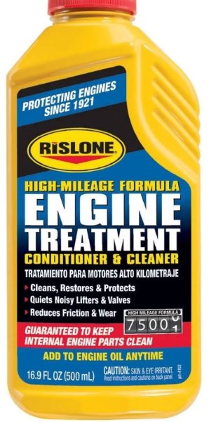

Back in the day we would use Rislone, a couple or three quarts and run the engine for awhile. Like stated previously, it did loosen up some sludge in a 258 that wasn't getting any top end lubrication and resulted in a bad rod knock. It really cleaned out the sludge on a high mileage engine. (Don't know if this is the same product as back then.)
