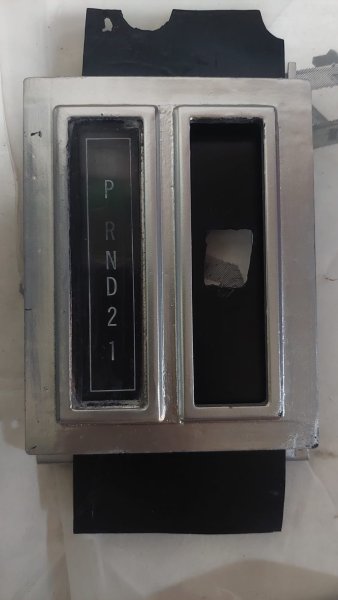

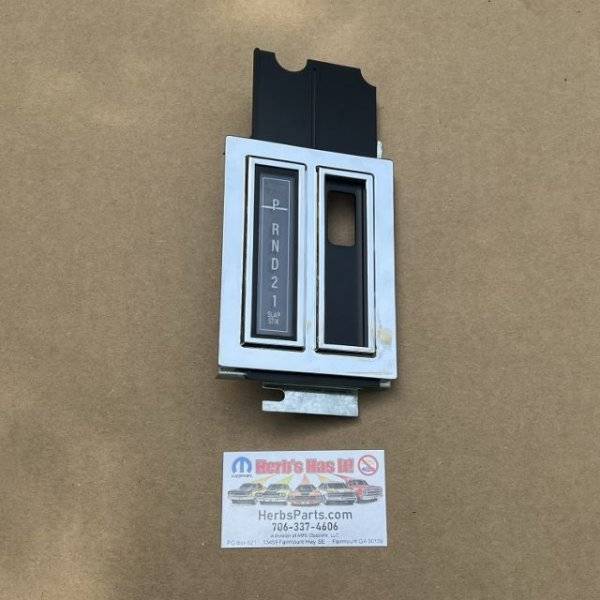

Hi guys, im restoring a 72 Charger SE with my dad, and the shift selector lens that the car has rn only has PRND21, but the Classic Industries website says that this car came with the PRND21 Slap Stik, i wanna know whats the difference between them, and see where can i buy the PRND21 lens
(i took the slap stik image from the internet, not mine)

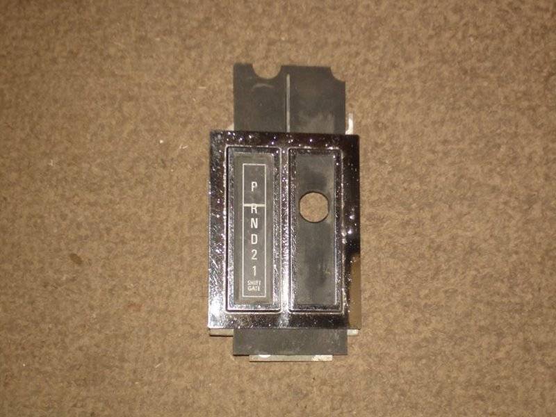

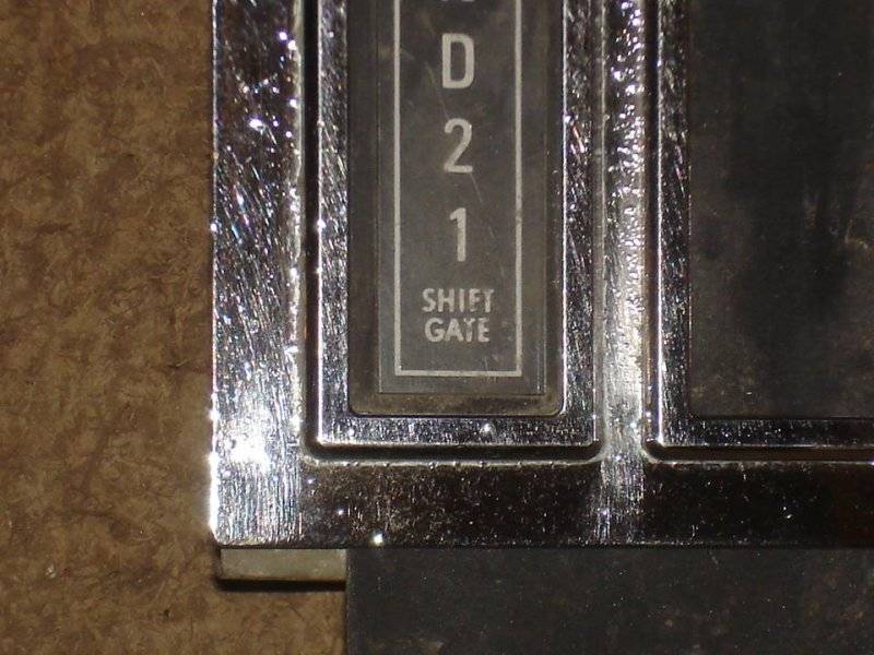

Early 1970 cars had "Shift Gate" (Early Aug builds)

Well, the car was bought in January 1972, I asked my dad if he knew something about this topic, and he said that the shifter, lens and bezels (the whole kit) its from a 77-79 Mexican Super Bee (Volare Road Runner in the US) so i guess i got my answer on why its different.
Our car has an engine and trans swap from another 78 Super Bee (installed by the previous owner) and now my question is, whats the meaning of slap stik, its just a model, or it has a function?
I was going crazy because i didnt found anything related and thought it was rare because the car was for the Mexican market
What i get for not asking first lol
Thanks a lot for your time and explanation
Slap Stik was the shifter mechanism installed in performance versions of Barracuda and Challenger, from 1970-on. When in DRIVE, the automatic transmission would shift normally though its 3 speeds. When shifting manually, starting in 1, the shifter will only shift to 2 with no possibility of an overshift to 3 or NEUTRAL. To shift to the next gear, pressure must be released on the shifter handle. A ratchet mechanism resets the shifter handle, and lets it go into 3 only. Pressure on the handle must again be relaxed to allow a shift to NEUTRAL. Without this Slap Stik mechanism, the non-performance shifter could easily be overshifted from 1, 2, 3, into NEUTRAL or REVERSE, while racing. I adapted one of these Slap Shift mechanisms into the shifter in my 1967 Coronet R/T. It works as intended, allowing only one shift at a time.
