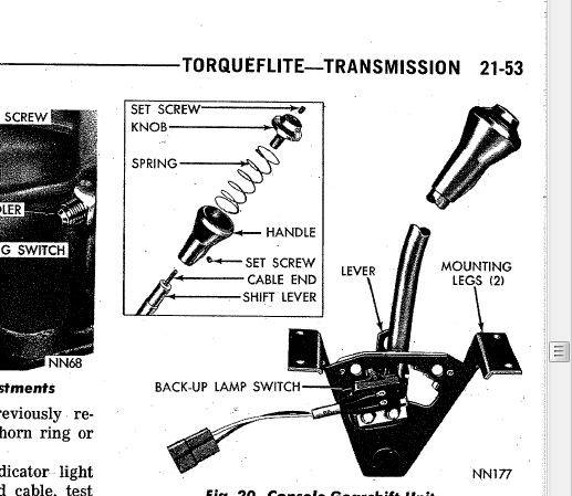

If you need it I can take it apart again and get a picture of the spring.
It only takes a minute.
I'd say the spring is 1 -1/2" or maybe 1-3/4" it's not a heavy spring.
yeah.. my first guess was actually 1.5 but then with the spring standing in the link it almost seemed longer... but maybe odd angle.
Fran:
I think that might be an older year?
Mines a '74 and that handle in the photo isn't round like the '74 it seems.
I believe those are drawings believe it or not.
Your first guess was a good one. The spring is not as long as the picture would indicate.
