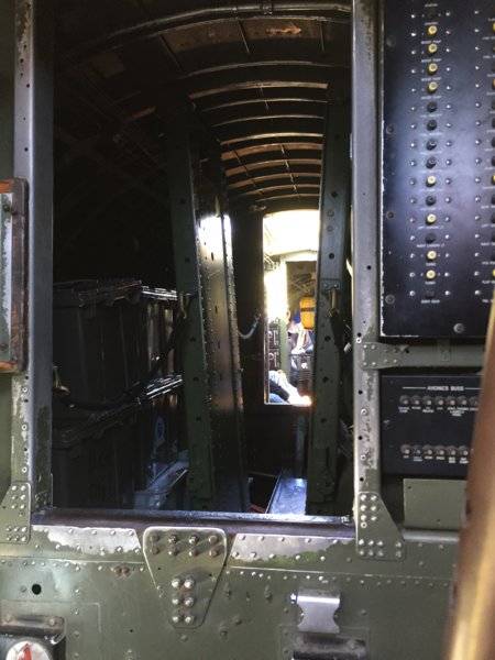

Terrible situation, loss of life should outweigh the plane. Hope the cancel culture we have become keeps out of it. I rode in this plane back in 2015. Filled me with pride. Also spawned a renewed interest in WW2. Been reading up ever since. I'm sure these living history displays have done the same for thousands of others. Any speculation at this point is just that. Just a shame no matter the ntsb findings.
