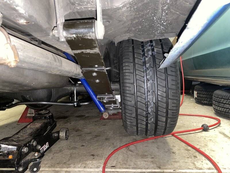

Why spacers?
I needed to get the rear tires out just slightly. Normal driving I had zero issue with rubbing. On the track in high load corners, the inside of the tire would kiss the inner wheel well. Not enough to damage the tire but since I could solve it easily with a spacer, I did. I highly recommend spending the money on a quality billet spacer, not a cast aluminum one from the local parts store. I also would be careful on using a spacer without upgrading wheel studs.
One extra note….check the torque on your lugs often.

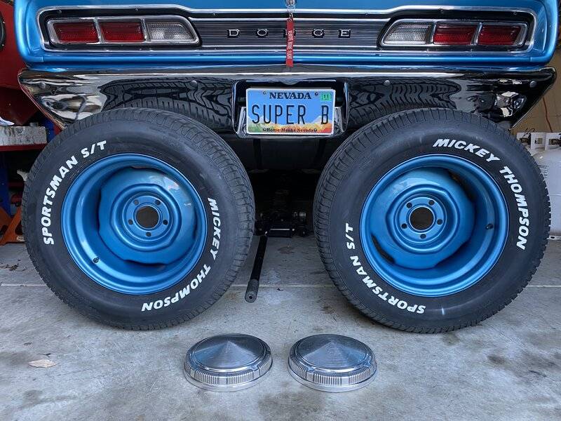

So in this post, I want to discuss my tire setup first, When I ordered my rims and tire, I researched the heck out of FBBO, amongst other sites, and searched things like “biggest front tires”…”Largest rear tires”….”wheel back space”….etc. I could have easily upgraded to 17’s or 18’s and my tire options would have opened up but I really wanted that old stock car look.
Here’s what I came up with:
Front Rim: 15x8, 4.5 bs
Front Tire: 245/60R15
Rear Rim: 15x10, 5.5 bs
Rear Tire: 295/50R15

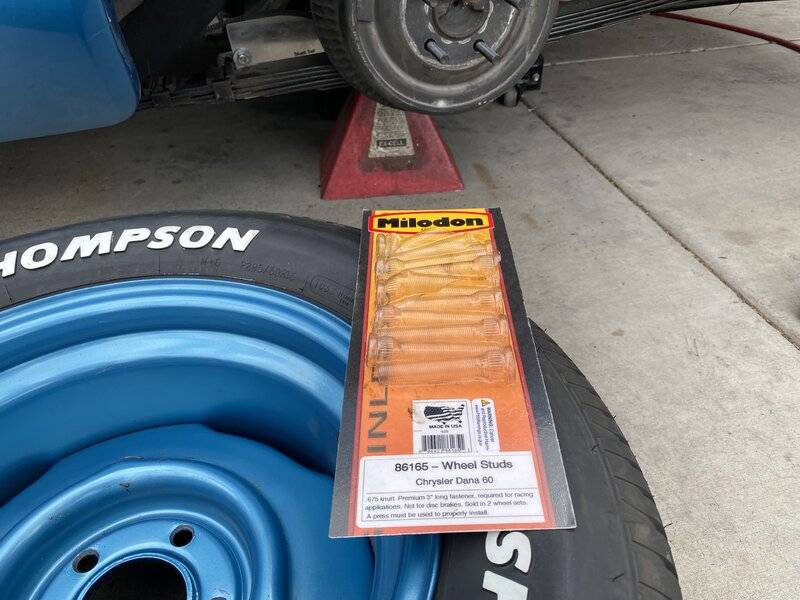

These tires are roughly 26.5 in diameter front and rear for balance. I studied tire sizes over and over again and compromised with this setup to be safe. The tires are Mickey Thompson's Sportsman S/T's which have a treadwear rating of 440. The only issues are the front wheel weights would contact the upper arm and the rear tires just kiss the inside wheel well on hard turns. I went to stick on wheel weights for the fronts and added ¼ billet spacers in the rear. One important thing to note is I upgraded to 3” wheel studs that were stronger than stock
I start the day off at 32 psi and as the temps come up, I’ve seen the pressure rise 3-4 psi on a hot day once I get off the track. My tire temps are even across the rears and a little warm to the inside of the fronts. Mostly because of the extra front camber but the temps indicate my pressures are good. I’ll go over my alignment later but here is what I’ve learned about these tires on the track. The tires are a bit harder than I’d like at the 440 treadwear. I’d like to get more front tire but I’m limited on what is available. After 3 track days, I’m at about 2/3’s tread remaining. These tires are very predictable and give great feedback when they are starting to lose grip. I feel these are a great option if you are on a budget. If you really want to go fast, upgrading to something with a lower treadwear rating would be best. I do push the front tires before the rear ever starts to get loose. That could change if I had more horsepower and could steer more with the gas pedal.

Where the studs needed with the required 3mm spacers?
Yes, kind of. With the original studs on the right side, I wasn’t comfortable using them. They were flush with the outer edge of the lugs and I’d prefer to see a little thread protruding out of the lug. On the drivers side, the originals were changed out to regular threads and were a bit longer.
Wonder if they'll fit under the dog dish caps...
