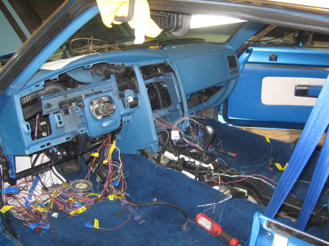

Started the re-wire last weekend. Unbelievable how much wiring there is in the new cars. very confusing.

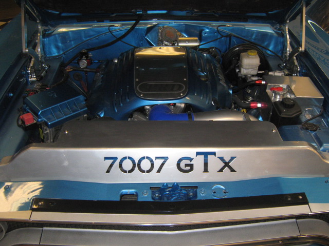

Also a pic I have not posted of the engine compartment. This will change some in the fuse box area once we get the new Haywire panel and all the relays we will need installed and a cover fabbed up for it.

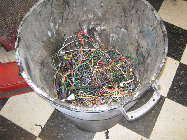

The trash can is only 1/3 of the wire we have removed and there is still easily that much more to go
looking good/great
keep it up
wiring is always fun...LOL

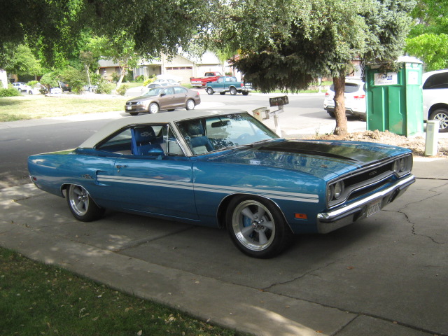

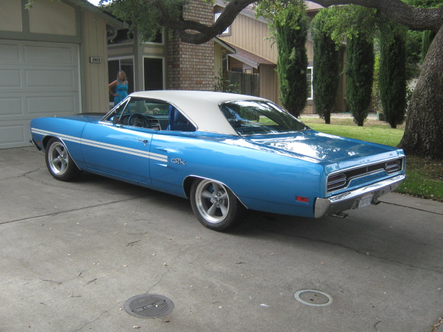

Finally home and in the driveway. I wasn't here 5 minutes and 2 people stopped their cars to gawk and ask questions. Who needs a car show?
