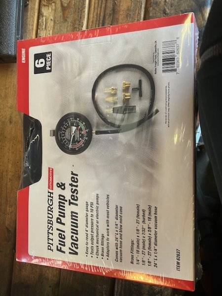

-if you have verified that the charging system is working correctly, set your airscrews per edelbrock instructions using a vacuum gauge and with the car in Drive with parking brake set. This should solve your fouled plugs. You can also verify that the needles are staying down at idle by removing the covers while idling and physically looking at them to make sure they aren't bouncing.
