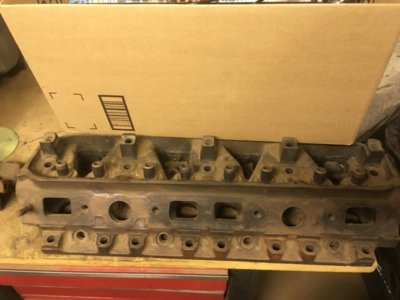

If you have damaged heads I have a set of 1968 or 69 383 hp 906 heads hanging around the garage! But I'm literally the farthest away in FL !
