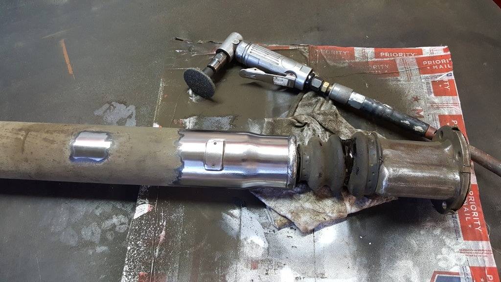

Funny you should mention that. I'm cleaning up my driveshaft and the coating is approximately 50mm thick!
And those "crappy" ball and trunnion joints were used behind hemi four speeds back in the day!
I don't think anyone gets parts cleaning results like you do! Looks like Chrome!
