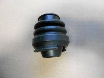

Decided to cut it off tonight, and found the top half partially sucked up into the cup that holds that joint.
The original boot is made that way to keep the grease in the housing.
New boot from O'Reilly went right on.
What boot did you get at O'Reilly?
