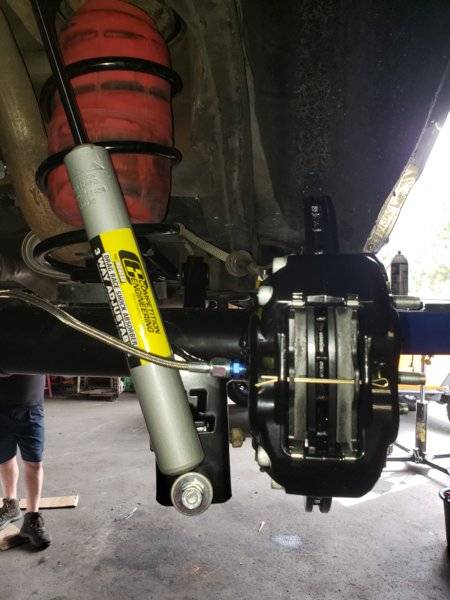

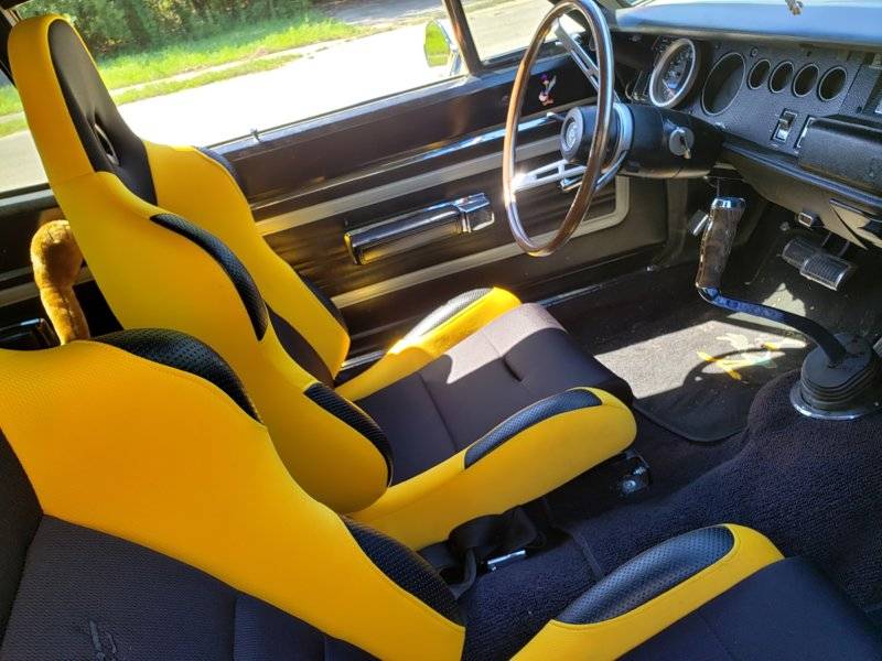

I have had problems with my 3x2 Holley carbs since Promax modded them, and I installed my Carter M6903 mech fuel pump. Once I get the issues resolved to where it's running fairly good, I am stoked to install my Innovative Motorsports dual wideband O2 system. That is going to be a GREAT tool to really get my 6bbl tweaked to the max! I also installed Viking double adjustable front shocks and Competition Engineering CEE-2730 rear shocks in an effort to improve traction. I replaced the bench seat with some nice yellow w/black trim Scat Procar bucket seats.

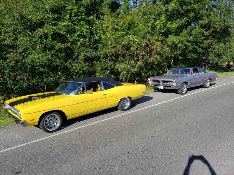

My car and my wife's 421 Tripower 65 GTO: Some GTO updates too!

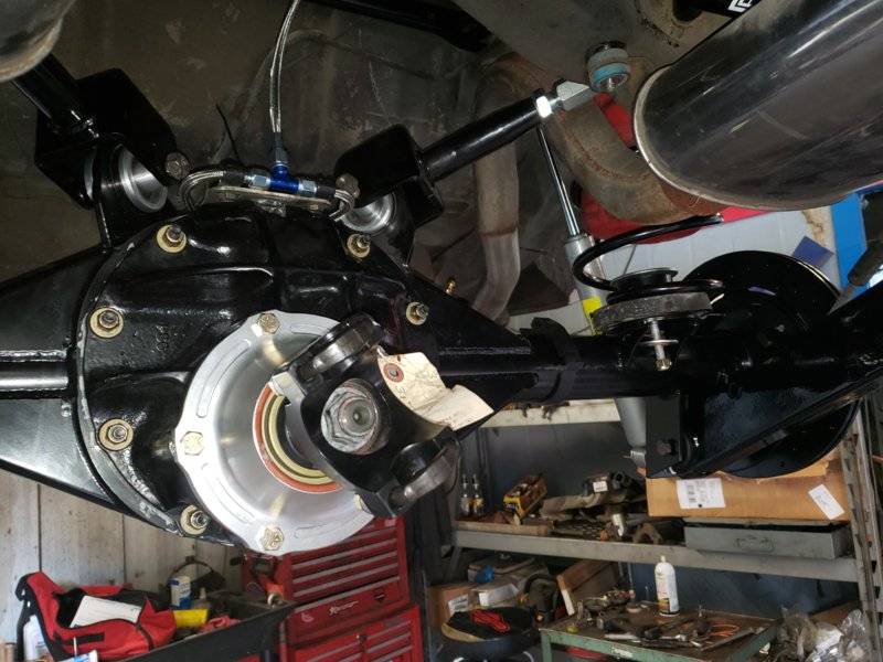

The new Quick Performance Ford 9" based killer rear axle assembly and UMI suspension parts for the 421GOAT.

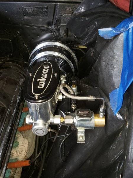

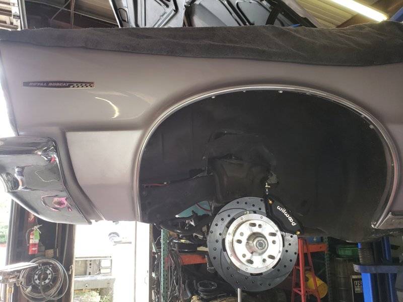

and the 4 wheel Wilwood disc brake system too (with line lock)

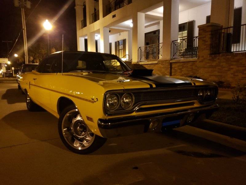

And another Roadrunner pic
I love the goats color, totally tit's! If I didn't have my 66-300 it'd be a 66 GTO! Gotta love the slab sides!
Thanks. There are a few things about the 65 that draw my eyes. The horizontal chrome and black taillight/rear panel, the stacked headlights with the peak at the top front and I think the body line (highlighted by the creamy white pinstripe) at the top of the middle sides that rises around the rear window and into the rear quarter panels. The 65 is a menacing, gangster like car with class!
The Isis mist 65', your wife's?
It's IRIS (like the flower) Mist. Chevy named it Midnight Orchid. It was a ONE year only color on the GTO. Yes, about 4 or 5 years after we missed out on a Maize Yellow Royal Bobcat GTO she found this one at Volo. The previous owner was Gunner Nelson!

and the 4 wheel Wilwood disc brake system too (with line lock)View attachment 684205 View attachment 684206 View attachment 684207

Beautiful cars! I see your '70 Roadrunner has the "larger diameter 15x7 rallye" wheels on it. How do you like them? Size(s)? Did you have to modify your wheel wells at all? Tires? Sorry for all the questions....I've been looking at those wheels.
Year One Mopar aluminum Rallye wheels.
8x17 front w/4.5" backspacing
9x17 rear w/5" backspacing
315/35/17 rear drag radials
TOTALLY STOCK suspension and wheelwells!
The rear tires are perfectly centered and should have come from the factory this way! No rubbing at all!
