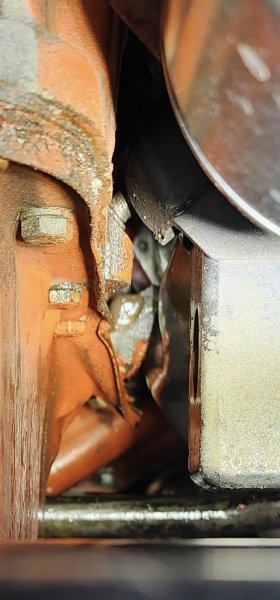

This is the only pic I can get for now. Block definitely has a window in it. My best guess is the hardware on a rod end broke? but I'm really not certain. It looks like a rod became detached from the crankshaft.

YES!!! And with a big block mopar with stock rods, good rod bolts, and stock weight pistons it is almost always because the rods are stretched, raising the compression after a missed shift or broken trans, or driveline. They run better than ever then boom driving along normally later. You should know your compression after a rebuild and test it after an over rev, any increase change the rods.

That sucks. I'm curious to see the internals too.

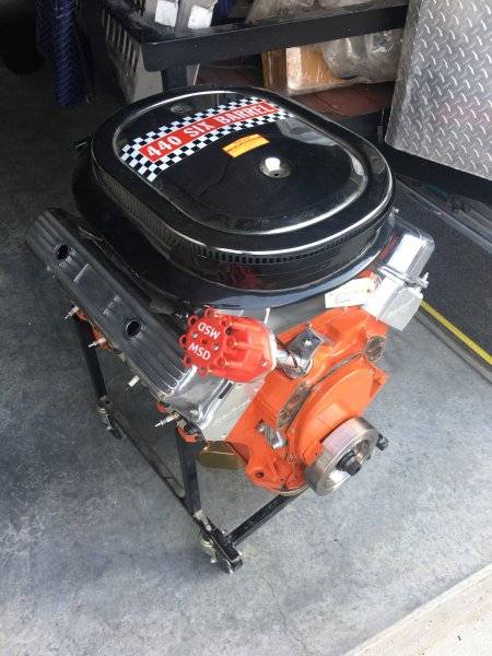

71 440. I only know it has the 6bbl harmonic balancer, "eyebrow" piston valve reliefs, stock bore, and a Purple Stripe 292°/.509 cam. 452 heads. I installed the CompCams: valve springs, because the stock ones were WAY worn out (weak), locks and retainers, and new hydraulic flat tappet lifters, and new stock pushrods while I was "in that neighborhood". That all began with a bad lifter, and what I (correctly) thought were weak springs. When I first got the car, after I got the 6bbl working properly, only a few hundred RPMs after the HARD pull started it would literally fall on its face. AFTER the valvetrain component changes, it DEMANDED that I let it spin to 6k (6,200 actually). I absolutely wasn't forcing it, I didn't even have a tach, I could just feel what it wanted!

It really was, especially if you look at the parts list. I have to believe the cam w/upgraded parts and the 6bbl intake and carbs, and 1⅞ TTi headers are what made it pull so hard to 6k+.
