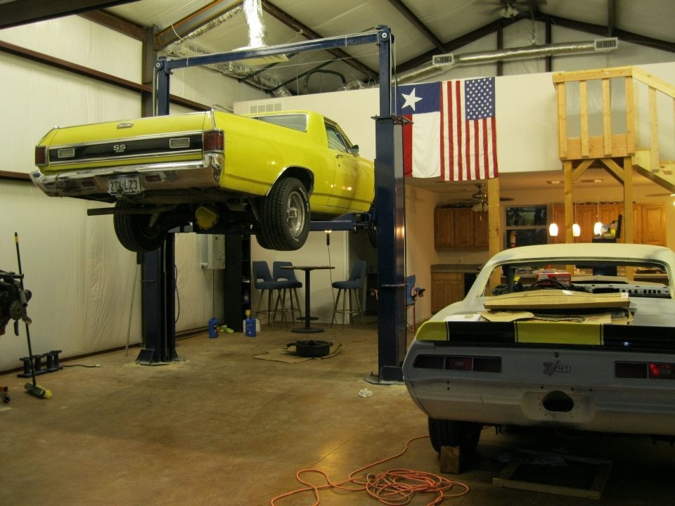

Figured I'd post a pic of the lift, as you can see buying non import equals more mass! Imports focus heavily on packaging, fitting as many units as possible on the container non rigidity. Hope it lives up to my expectations.

Absolutely but keep in mind this is just a hobby for me so it's not used like a service shop lift would be. I can say there's been zero issues, very happy with everything including the lift rate. The biggest thing I've had on it is my brothers Mega Cab Diesel Ram and there was no noticeable difference in lift rate or any signs of it struggling in any way. I thought I wouldn't like the lock releases needing manually disengaged from each side but honestly it's a non issue. This would be easy to modify but your releasing them when you have a car lifted which makes it very easy and handy.
Like a power washer I would never be without one now. I've found another benefit is that I no longer have to keep a set of saw horses around or even a cherry picker (very handy for loading heavy objects into your truck) lol.
